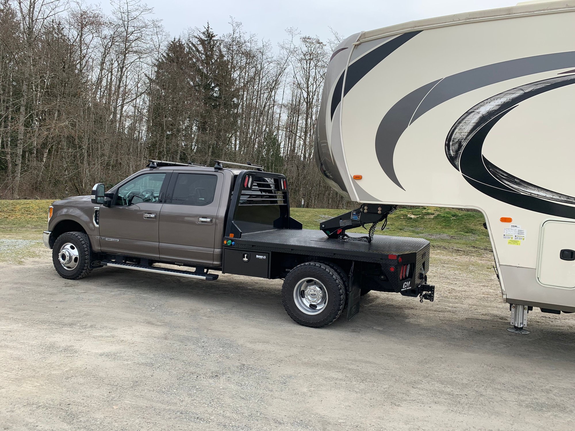

Recently removed the pickup box and installed a CM flatbed. A few complications with relocating the 360-view camera and deleting BLIS and parking sensors, but Forscan is great for that.

I've been looking at that bed for a long time. I think it's the best one I've ever come across. I just need a place to store my factory bed...
