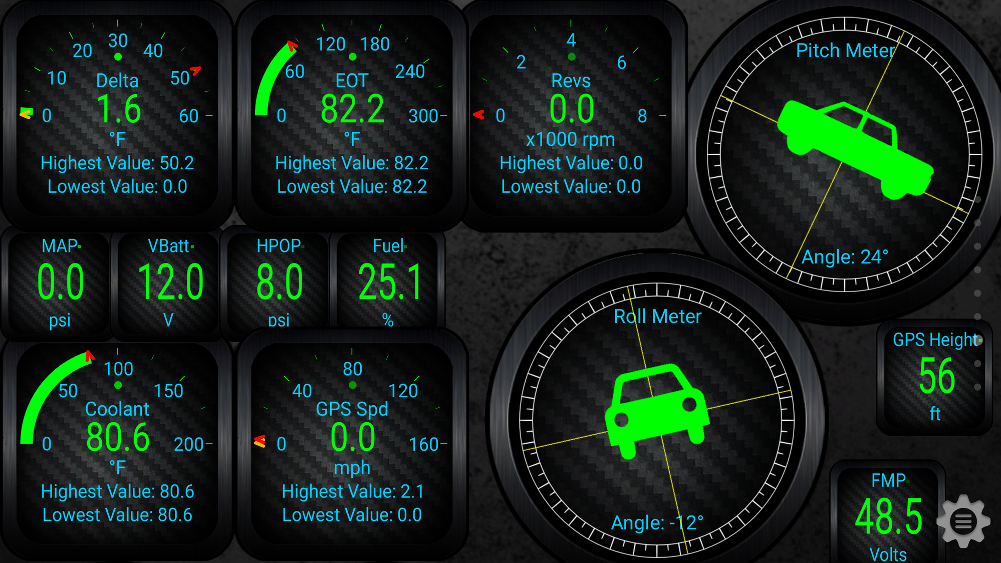

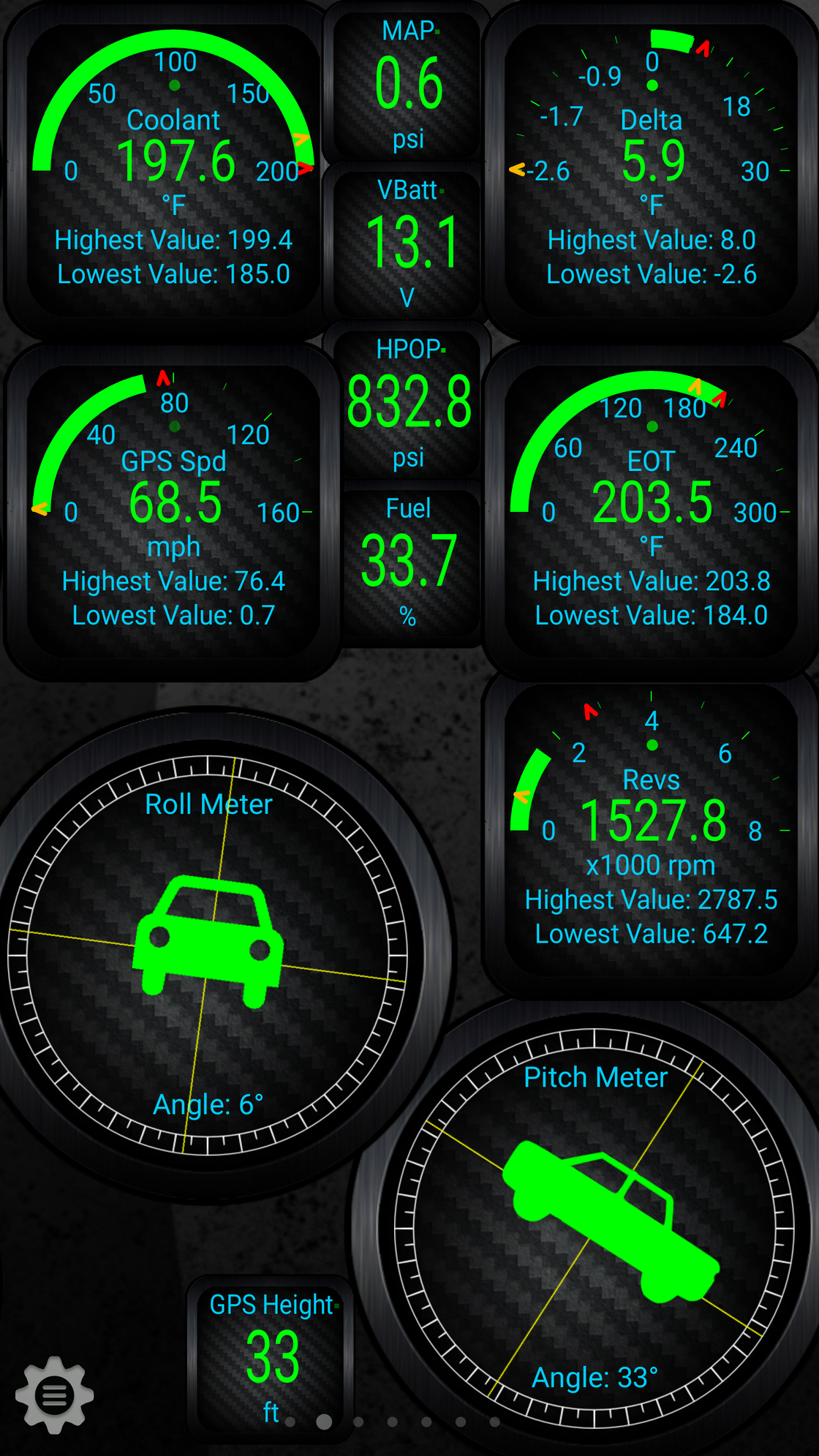

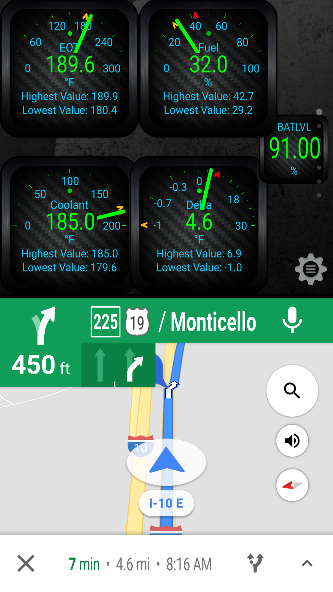

this is bizarre- i have not done the thermostat (i did replace the board in the ficm). Yes I am a financial planner that also rebuilt his own ficm.
I made a run on the highway as tested and i enclosed the numbers. I also have some readings after a trip to homedepot. coolant mystically is warming up enough. maybe the t stat is intermitent. who knows.
cold soak this morning. i noticed the oil temp is off.

That cold soak is not horrible. How many hours did it actually not run?
You are not even a full 2* off
Old May 7, 2018 | 02:08 PM
  #35
conig's Avatar
conig
Joined: Nov 2017
Posts: 21
it sat for a good 11 to 12 hours. it was run maybe 2 the day before to check the ficm.

I think you need to run longer to get a true reading on the EOT and ECT. . When I run the van for an hour, the EOT-ECT is 7 degrees. It's been that way ever since I changed to an all aluminum radiator. My van runs at 204 EOT 197 ECT.
My cold soak sitting for 7 plus days was 2.5 degrees @50 F

i normally test with the truck on cruise set at 70mph factory gauge.

25 to 50 miles, not perfectly flat. thats 2000rpm for me which is what I beleive delta should be tested at.
ambient 75-80
