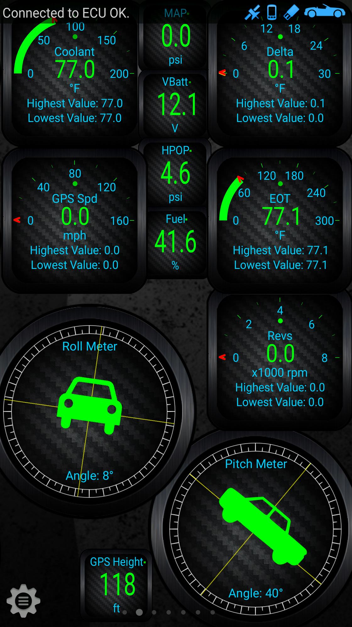

What are the temps after a cold soak? After it sat for around 24hrs? Are they actually rising to that temp and then stopping?

in the morning ect and eot measure similar to ambient but normally the same.

Yeah my vote is for the stat too. Looks like it's trying to keep the oil temps lower. The stat is a great place to start. Cheap and easy.

Looking at the screen caps, the limited range of EOT paired with the limited ECT range makes it not seem as unusual. In the last capture the lower range value of each extends much further down and is comparable, so I'm thinking that we're only seeing limited data. You could try logging data from a cold start all the way until ECT and EOT reach their max values, but I still think this is another case of a bad stat.

cold soak reading and this morning warm up till my office.

Is your battery voltage 12.1 V?
Edit: Sorry, you wernt running in the first pic

yep but my ficm is low and I am about to rebuild it.
