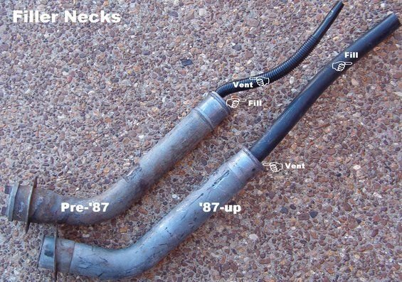

On these older trucks, there is a small plastic vent pipe that sits in a clip inside the large fill pipe where you put the station nozzle. This small vent pipe likes to fall out of that clip, and then it gets in the way of the fill station nozzle and keeps cutting it off.
There is a lot of air coming out of the tank when you putting a lot of fuel in it at the station. All that air coming up the fill pipe needs to be kept away from the fuel going in, or you get splashing and gulping. I think Ford knew they had a little problem, because on the later trucks they switch hose duties, and instead of the large pipe feeding fuel and the small pipe exhausting air, they switch it around to where the small pipe fed the fuel and the large pipe exhausted the air. I think they work better and could possibly be retro fitted to a early truck.
Franklin is exactly right. I installed a mid 90s fill neck on my truck, have only had it burp once or twice since, that was about 3 years ago. Here is a picture comparing the two necks:
