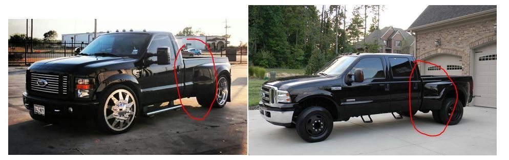

Uh oh! Found an image of the type of wheels/slim tires I saw on that crew cab short bed, but this image is of a F-350 dual rear wheel regular cab with short bed, says the wheels are 26's
https://i.pinimg.com/736x/6e/4d/90/6...e465c20b24.jpg
Wondering, regular cab / dual rear wheel / short bed? thats got to be a custom job, right?

Regular cab + 6.75' was not a frame length offered by Ford for a Super Duty.
That picture is an 8' bed though, the 6.75' bed duallys had a fuel port in the front of the driver's fender and no space between the fender and front of the bed. There is a fuel door on the bedside panel in front of the fender on the truck you posted.

Are you referring to the last link?
The description on the site I found it said "Custom 2009 Ford F-350 single cab short bed dually on 26's ...", so it is probably wrong.
If I get time I will try to find the webpage that has the photo, maybe there are other photos of it, I am not able to see any fuel port in that photo. I am assuming the fuel door should be round rather than squared/rectangle. I was mostly focused on the wheels, but the idea of a regular cab with a short bed and dually is an interesting idea.
It's hard to see, you don't see the seams around the door so much as the little tab that pops out to open the door.
It's a very starkly obvious difference in short and long bed once you see where the fenders are side by side, long bed has a gap from fender to front of bed, a short bed doesn't. Also you can see how the light makes what's apparently a big difference, but isn't. The second shot you can see the body line coming out of the cab right over the door handles and continuing down the length of the bed. In the first shot the light it as higher angle and that entire body line seems like if disappears, making the fenders appear to be mounting lower, but in comparison to the door handles they line up the same.
