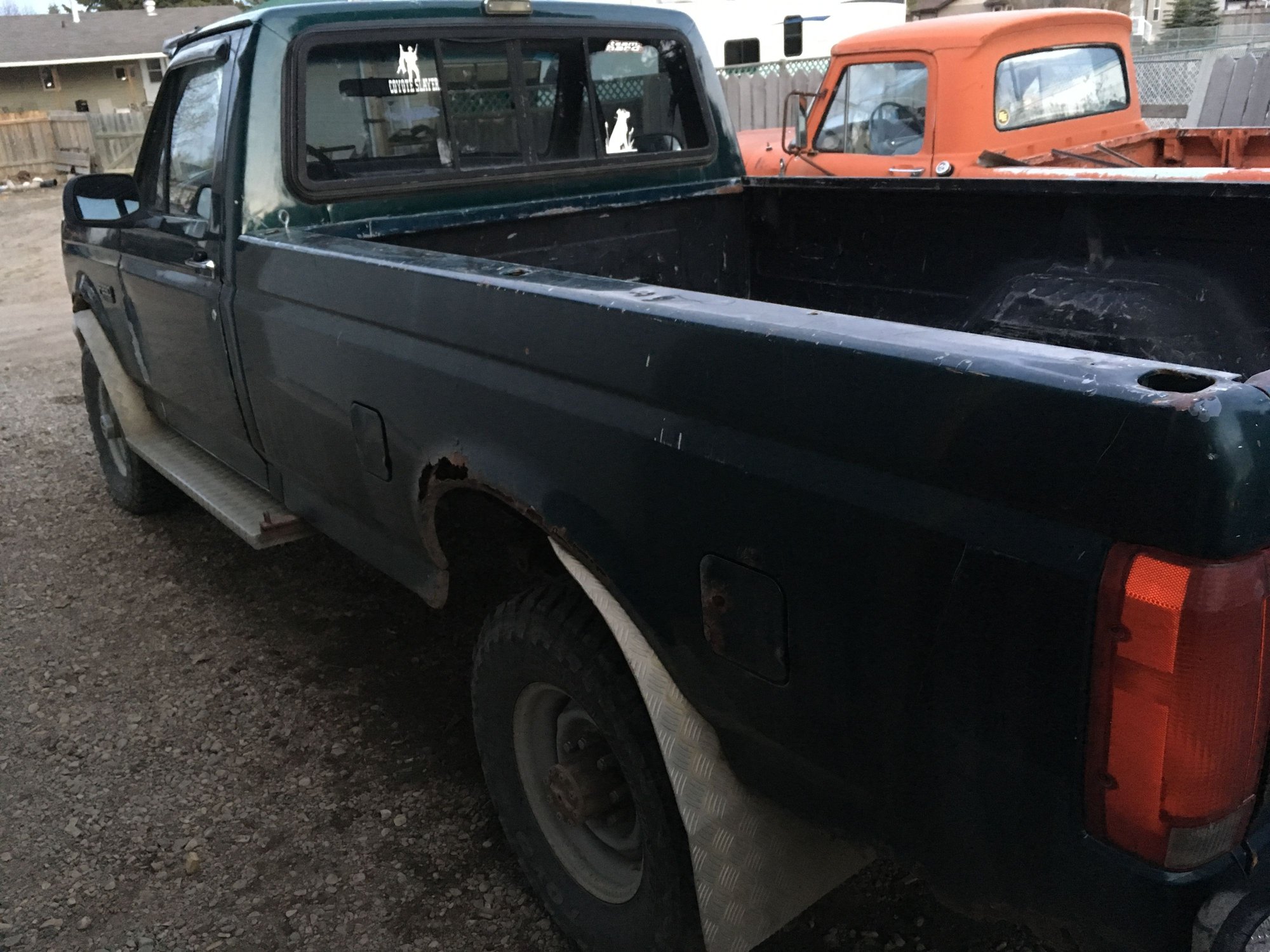

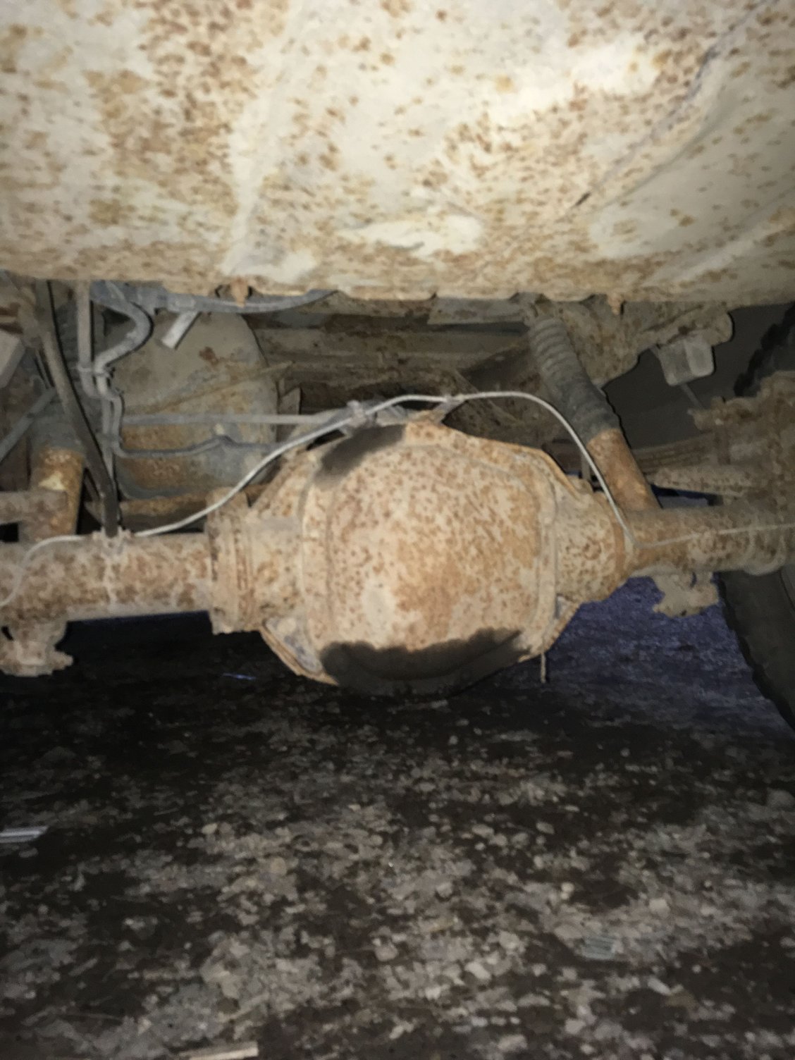

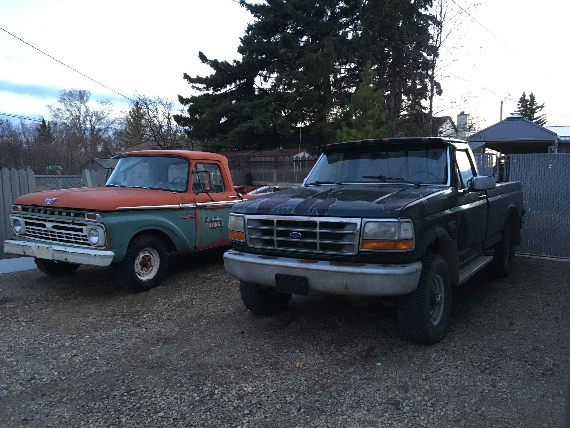

Here are some promised pics of the old beast. I bought it three years ago for less than $1000 which is cheap for around here. I had to replace the windshield, wiper motor and one horn to pass an inspection for insurance and have done nothing else to it. It did tow on a trailer that beautiful Merc parts truck sitting beside it. The ID tag on the drivers door jamb is long gone so I do not know what diffs are in it or what the gear ratio is.
Peelin' paint but straight hood
The bad side with no metal behind the mudflap
Rear diff
