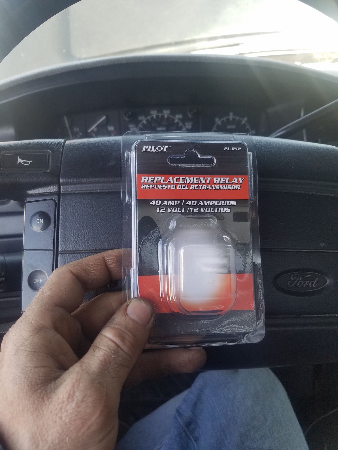

NO MORE CODE 213!! And all it took was a stupid relay. Still going to service the loose pins on the pcm connector

Yeah, no way a relay is going to fix Code 213. Keep digging, you are on the right track.
