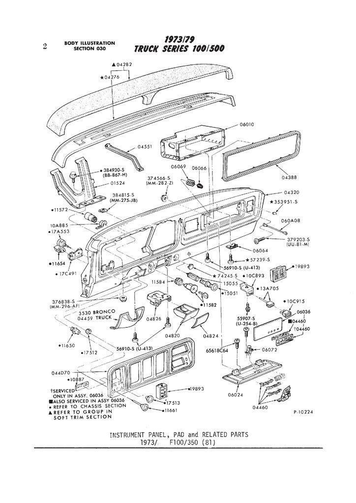

Both (outer and inner ) ***** pull off, you might or might now have to remove the dash bezel. Depends on is the PO ever removed the radio. Clean the shaft threads and use a deep set socket to get the nuts off. There is a rear support bracket attached to the back of the radio. Walk thru dash bezel removal...https://www.ford-trucks.com/forums/s...9&postcount=66
