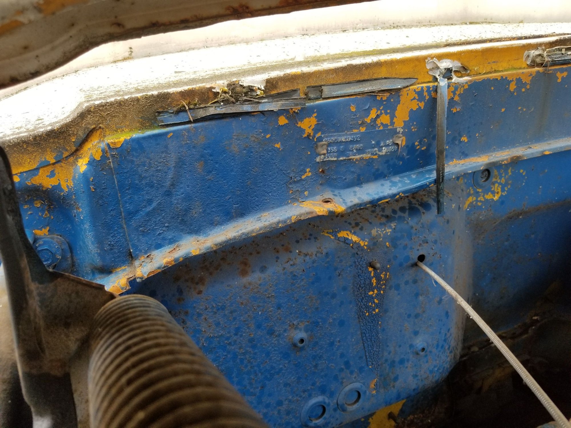

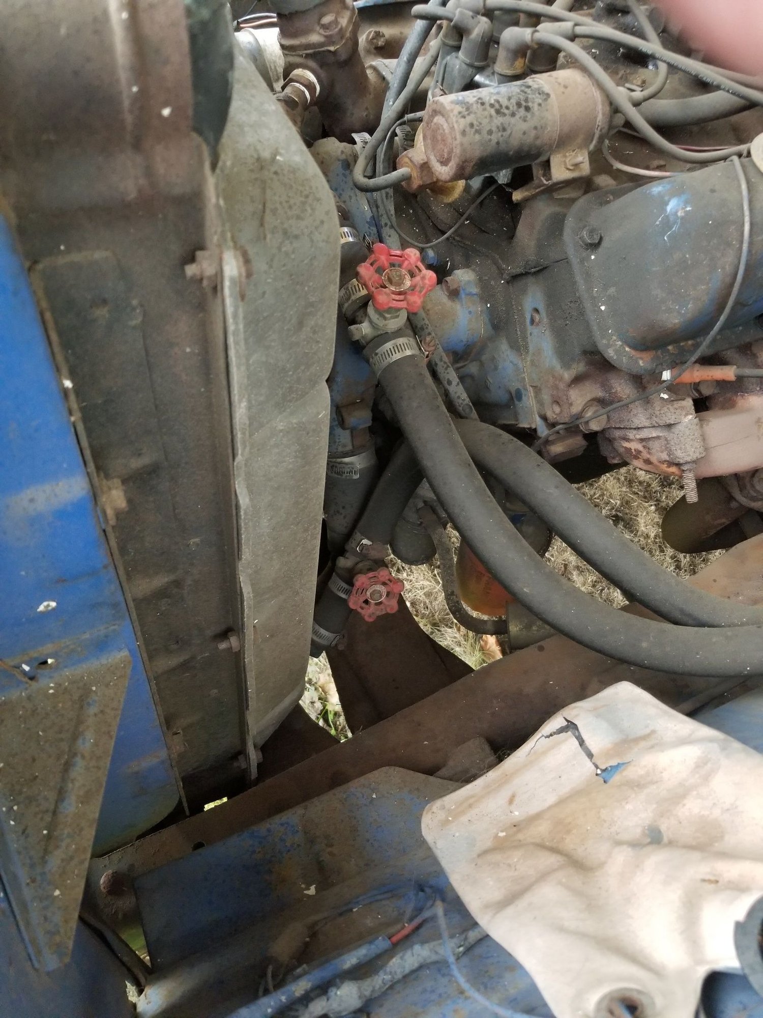

That is an FT series engine. Similar in design to the FE motors, but with lots of different parts. According to your 3rd picture, this is a "B600" model bus. In your first picture, I see a 2bbl carb. IF this engine is OEM, it is either a 330 or 361. The 391 was a 4bbl carb.
If you can get a legible picture of that VIN plate with all the info on it, we might be able to get you a decode. I am also going to ask to move your thread to the FE/FT engine forum.

Warranty Plate riveted to firewall.
B60 = B600 School Bus (gas).
C = 330 2V Medium Duty FT engine. 3rd line: 164 net HP @ 3,800 RPM
Cannot make out the rest of the VIN .. 5th digit is a letter for the assembly plant code, last 6 digits (1 letter/5 numbers) decodes to the year.

At this point in time, that engine could be anything in the FT/FE line. There's no way to tell for sure unless it's taken apart. The gaskets are not Originals. That intake's been off it at some point. I can see a corner of what looks like a Felpro Permatorque Blue head gasket poking out as well

How do you know it's not ? Be that as it may, it looks like it's got FT exhaust manifolds and thus it'll have FT heads and an intake. BUT the short block could still be either FT or FE. The distributor looks to be an FE part. Definitely not the larger FT with the the mechanical tach drive. Not sure if they ever used the FE distributor body in the medium duty trucks. saying it's definitely one or the other without actually pulling the heads is foolish.
