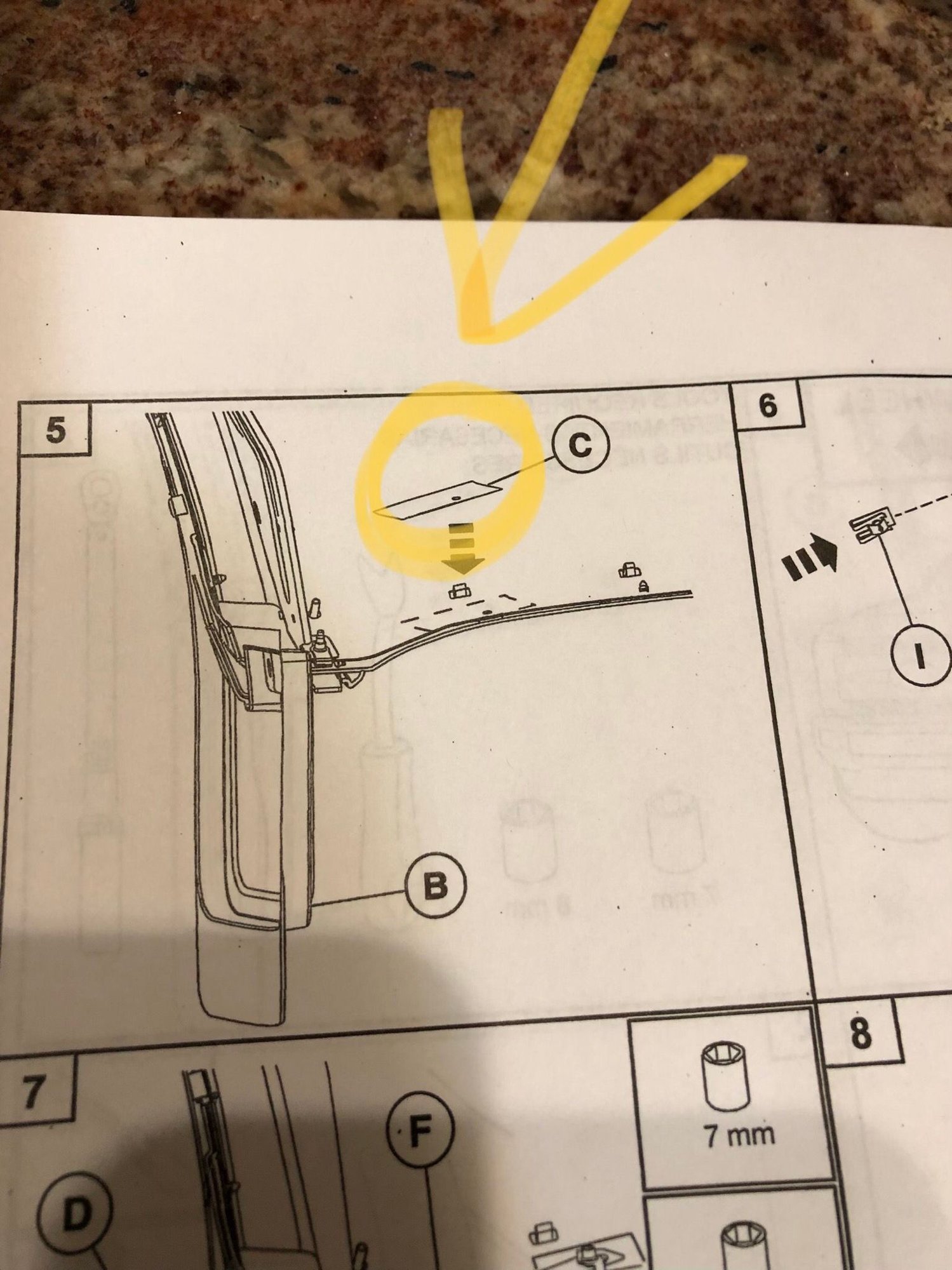

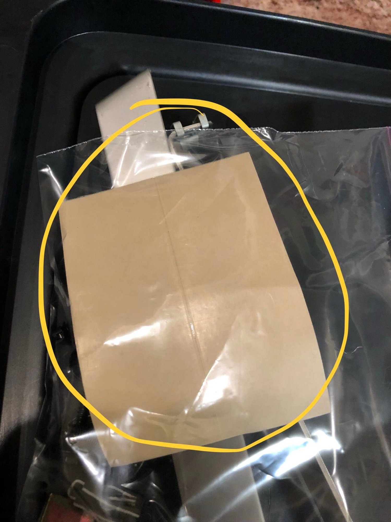

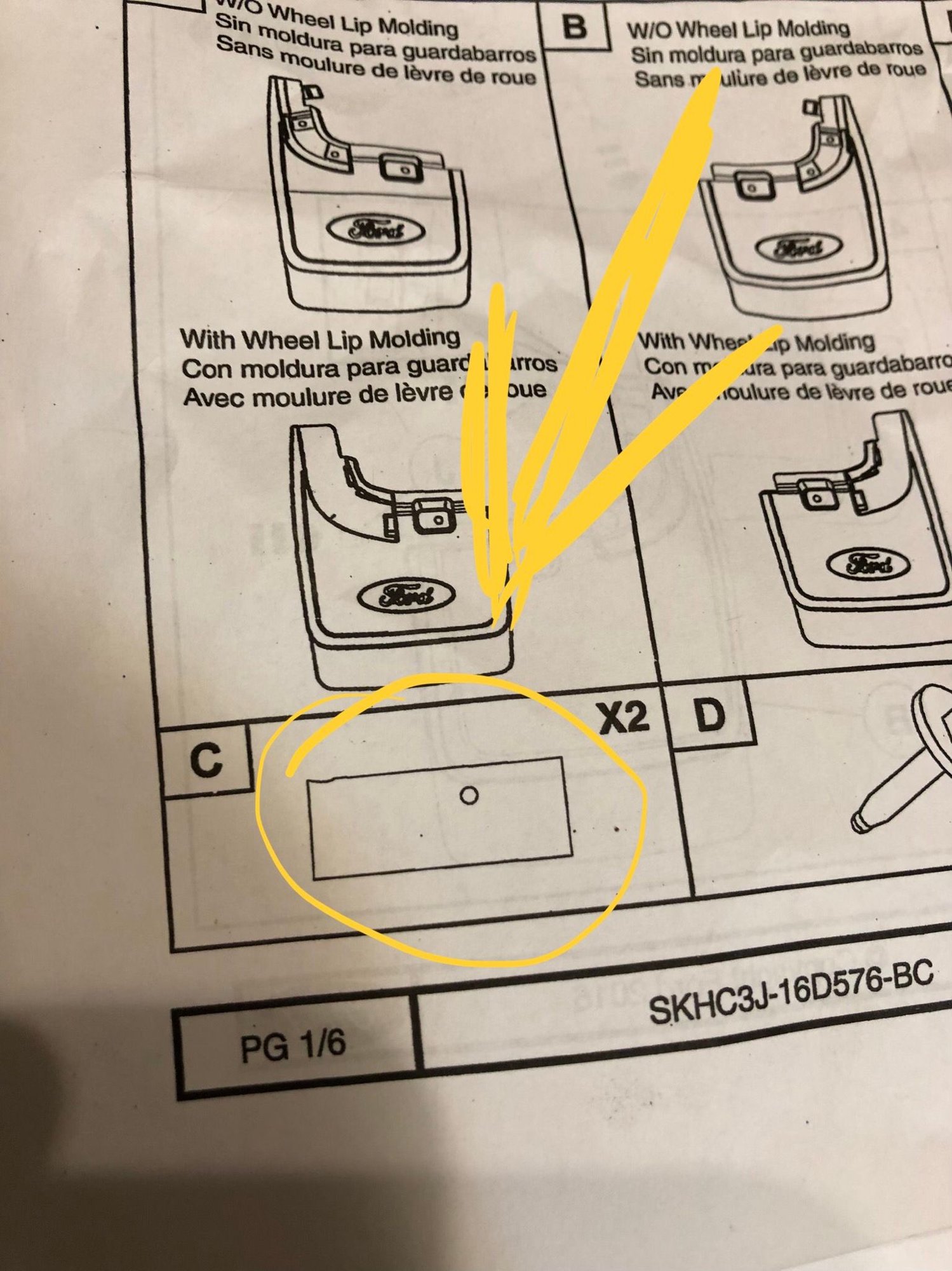

I was installing these.... then it got dark and I had to stop. But 1 question. What are these little clear pieces for?

They are there so the metal bracket doesn't scratch the paint and cause rusting.

On an aluminum body? We are talking about the new Super Duty bodies aren't we?

I believe its an added layer between the steel bracket and the aluminum to help against oxidization

That makes more sense to me.

Ahhh ok. I thought that at first but it’s so thin. If there’s any movement this protected might not last long.
