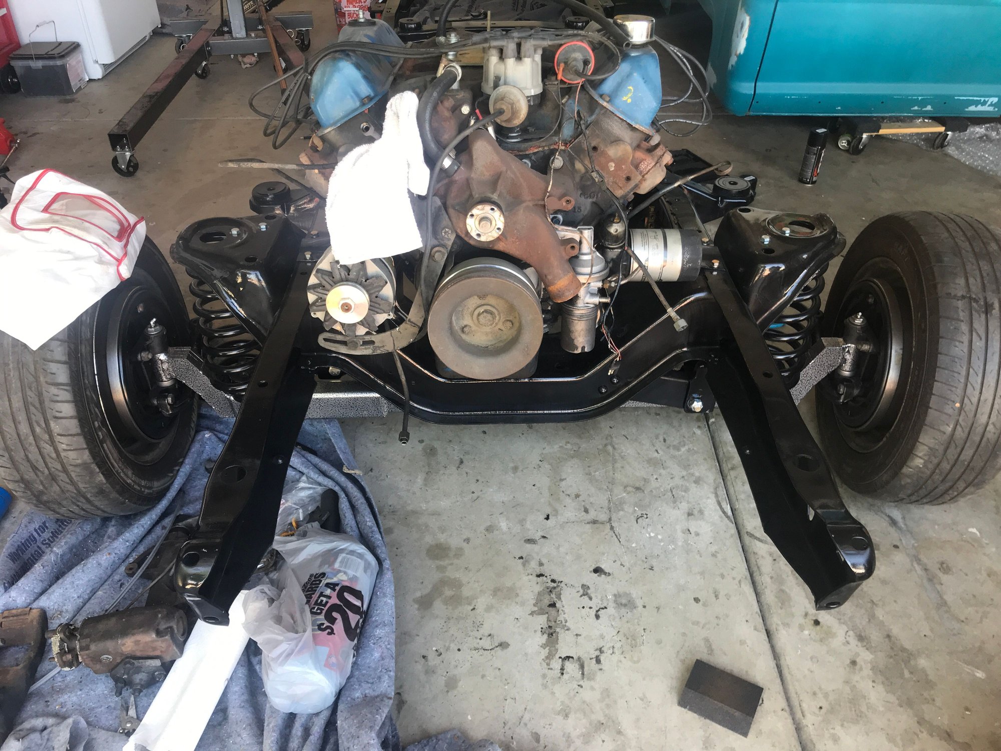

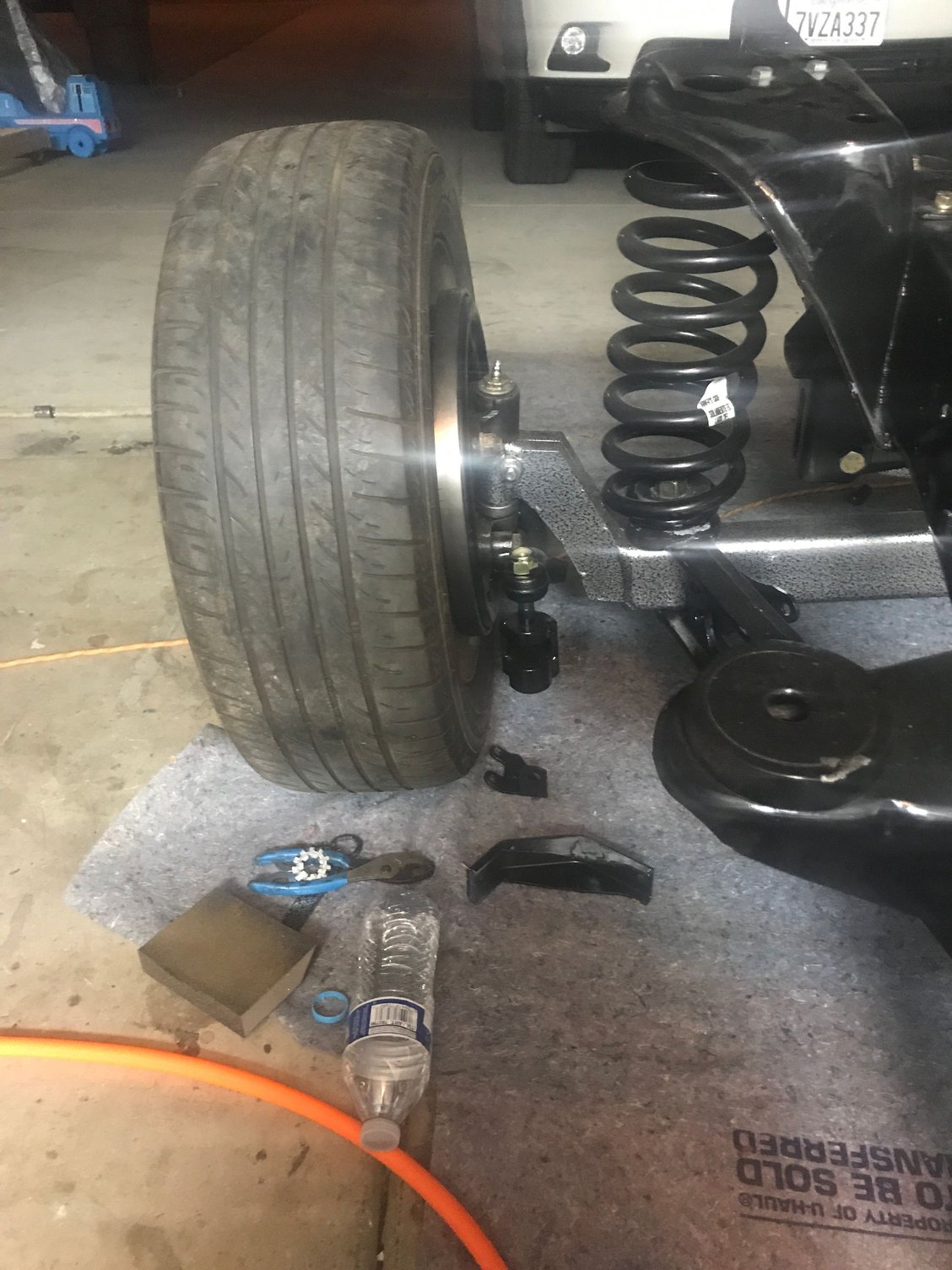

Hello all I am currently faced with a dilemma of epic proportions. I am in the middle of my 1972 f100 build and finished the front end today. A little background I completely tore down the frame and have it sandblasted and painted. I installed new DJm beams, new moon springs (progressive rate and factory height), New kingpins, new brakes the whole nine right. When I bolted in the front tires on tonight and noticed that one tire tilt out more than the other. I’ll attach pics to show you what I’m talking about and I understand there’s no weight on the new springs but my concern is that if that’s the case the tires should be tilting out evenly. Also I have not fully tightened the axle pivot bolt yet as I was told to do it once the motor was in. Any ideas?

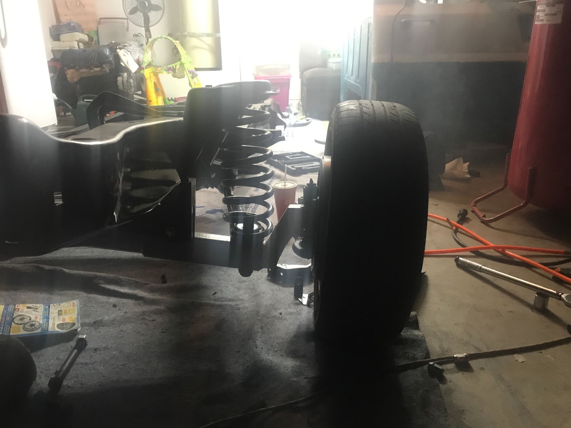

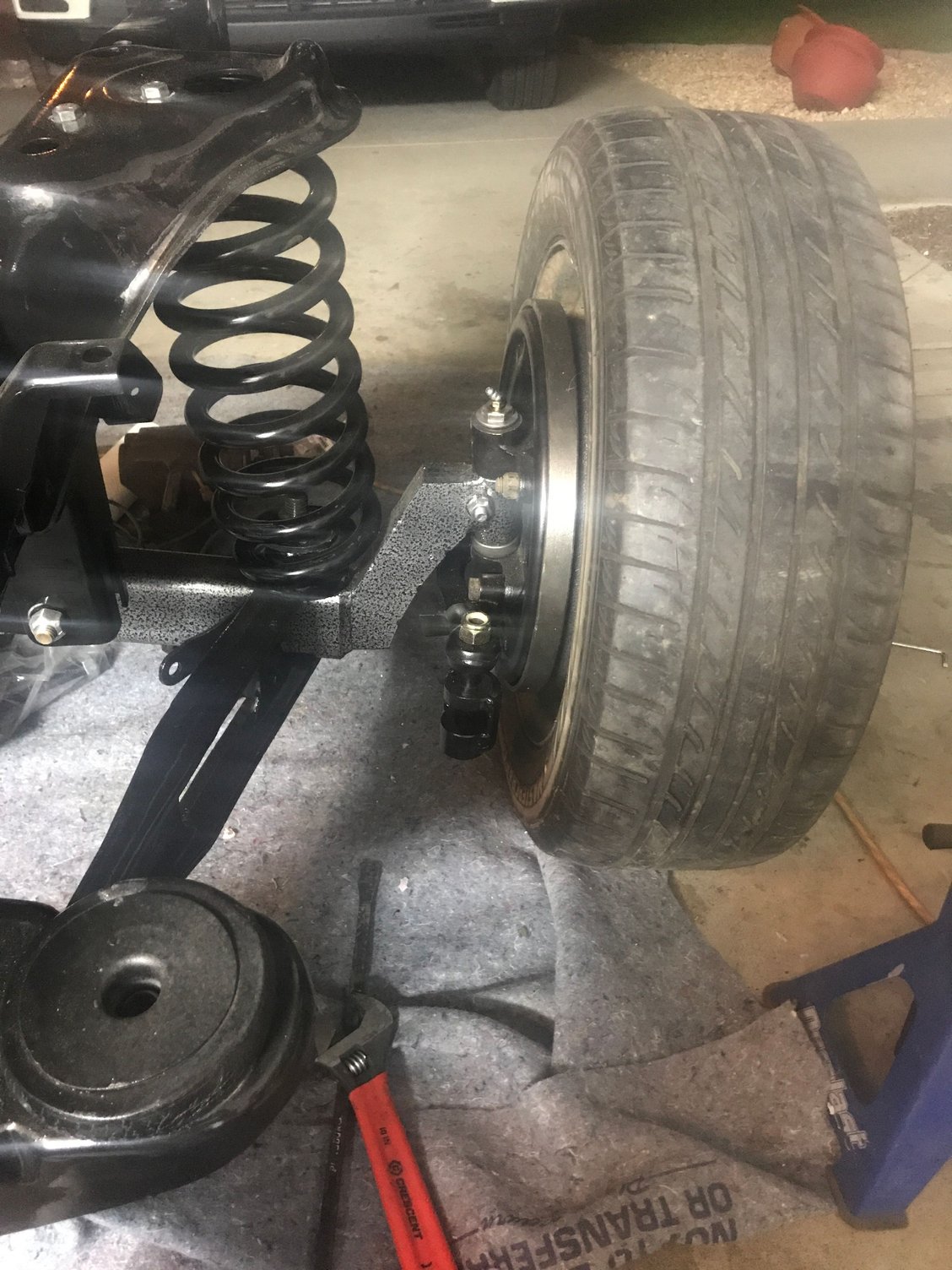

Here are some more

I could be over reacting but I saw this and lost my S*#%. Like I said passenger wheel sticks about 3/16th of an inch more than driver side even tho it looks way more

You are overreacting. 3/16ths? That's not much. The engine doesn't sit in the center of the frame for that matter so just wait til it's all together.

agreed ,don't worry about it till you get some weight on there.. Looking good !!!

Concur with the two previous posts... It'll settle once the suspension is laden. Your concerns are premature at this time.

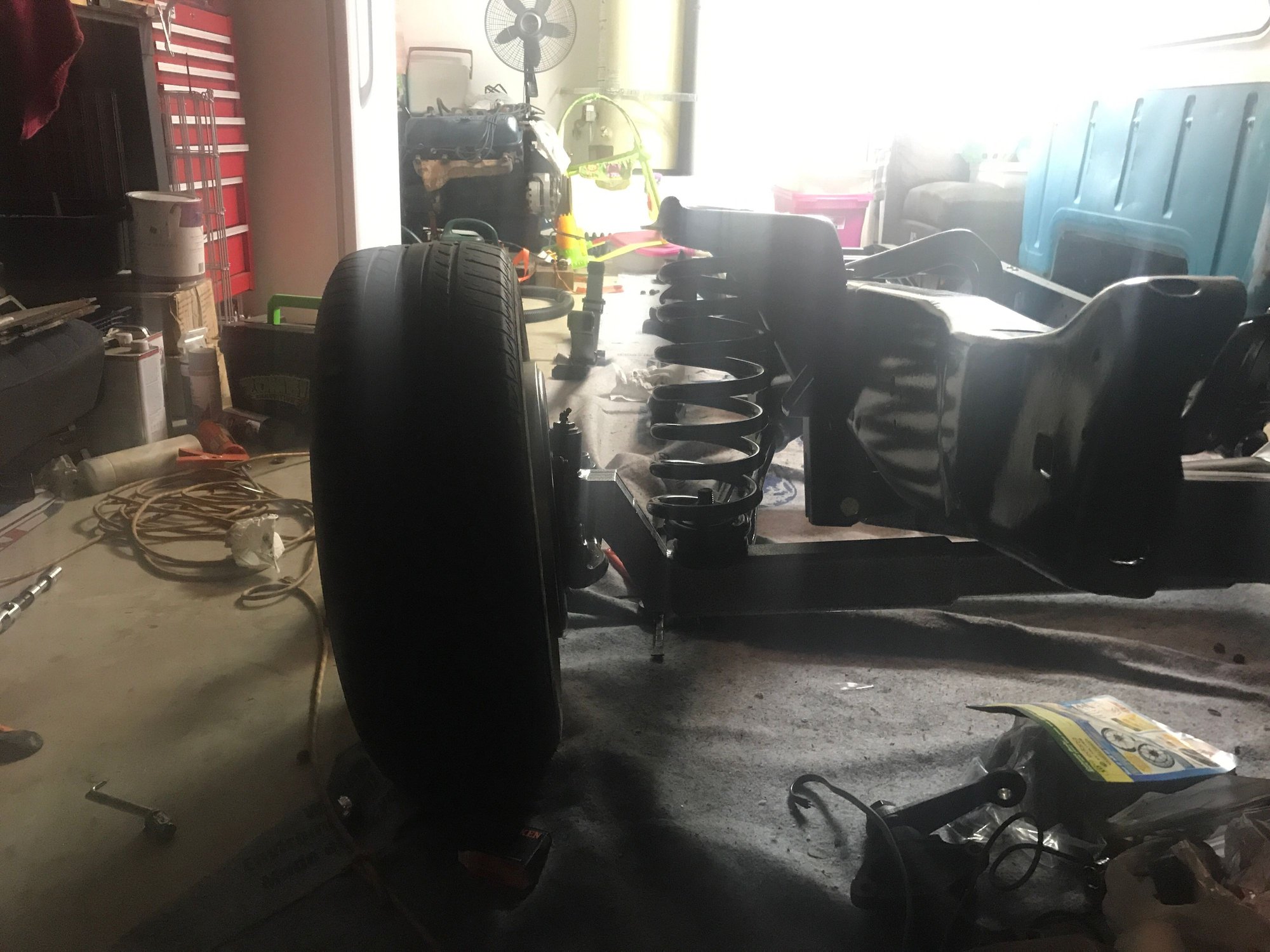

Ok so I couldn’t wait so I sat the motor and trans back in just to see where I’m at and it did help a lot. Going to leave the motor and trans in for a few weeks to see if it helps settle the spring a bit.

Roll your chassis forward 10 feet and then back into the position as pictured. Right now it prolly has some scrub/binding which is visually exacerbating the positive camber effect.
