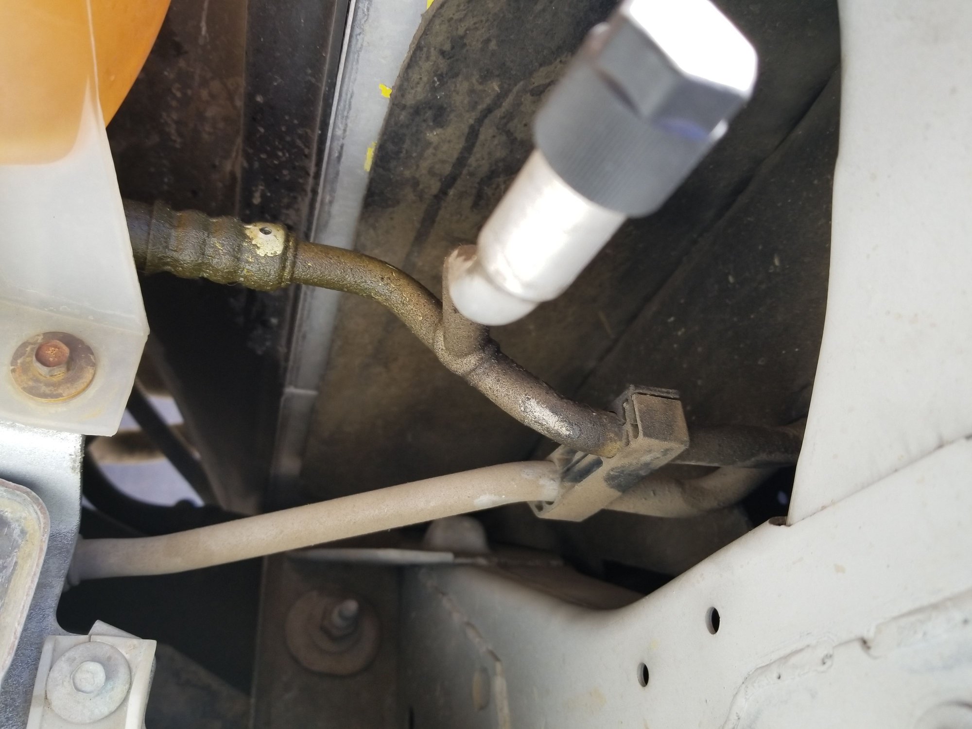

I'm pretty sure this was where he added the Freon ? The Line is all dirty/wet from something leaking .
My 03 F-350 V-10 A/C just went out !!!!
I had it serviced from a guy on Craigslist last year.
I think he over filled it ?!?!?Looked on rockauto.com
for the correct part,and could not figure out which one it is .
Any help is greatly appreciated !

it either your high or low pressure port... you do know you cant just replace that port, the entire system is charged or at least was .... lol.

I'm not sure if that's the high or low port, but the clean spot on the fitting right before the overflow reservoir looks like it has a hole in it.

That is a very suspicious looking hole.

That's the high pressure port/line, the low pressure port is on or at the accumulator. See all that greenish, oily dirt? That's the result of a leak.
On RockAuto, the replacement is:
Discharge Line (High Pressure - Compressor to Condenser)
FOUR SEASONS 56770 Hose Assembly Info
