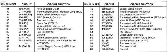

I repined the connector to fit the ECM, here are the two diagrams I went by:
So basically I just swapped my pins around to match the second diagram. I added in the 6 injector wires, MAF sensor wires, Intake temperature sensor wires and the resistor for the Park switch. I also plugged in an engine harness from a 95 f150 for the extra injector wires.
