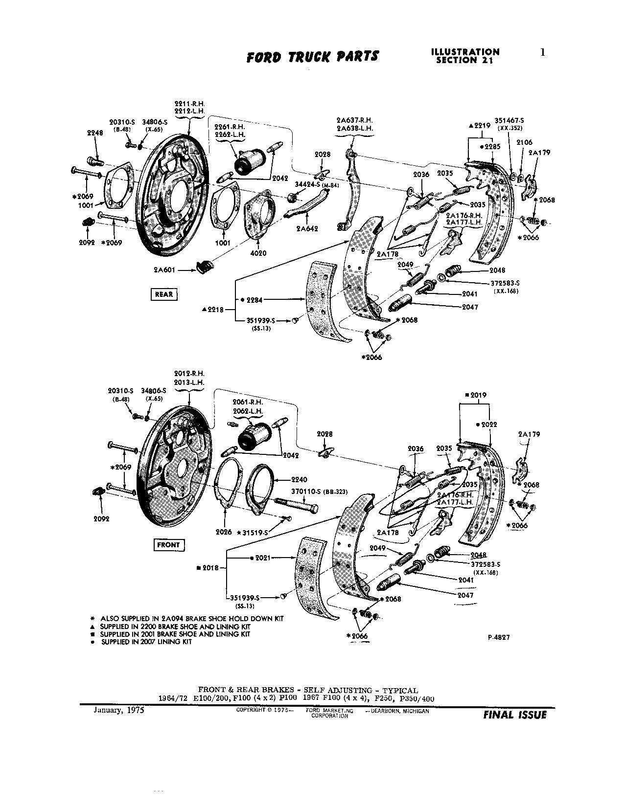

I just recently purchased a 1970 f100 ranger. Pulled the front brake drum to check the brakes and noticed a self adjusting mechanism ,is this standard I have seen this on rear brakes but never seen this on the front.

ALL 1964/72 F100 2WD's and 1967/75 F100 4WD's have front/rear self adjusting brakes.
