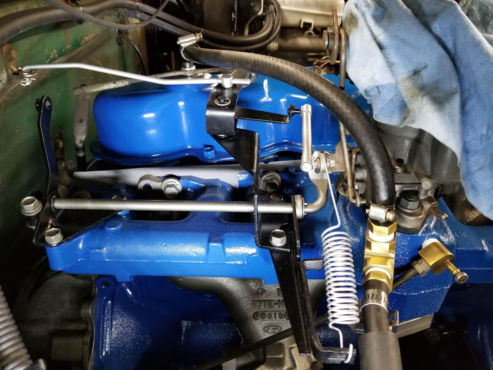

I recently had to figure out this puzzle when I reassembled them onto my new inline 300.

Ranger, can I have yours (: That definitely looks more like the schematic NumberDummy has been providing. Wish I could find those parts.
The lokar setup is for the V8 lineup. Have not visualized how to install the lokar setup on mine as of yet.
