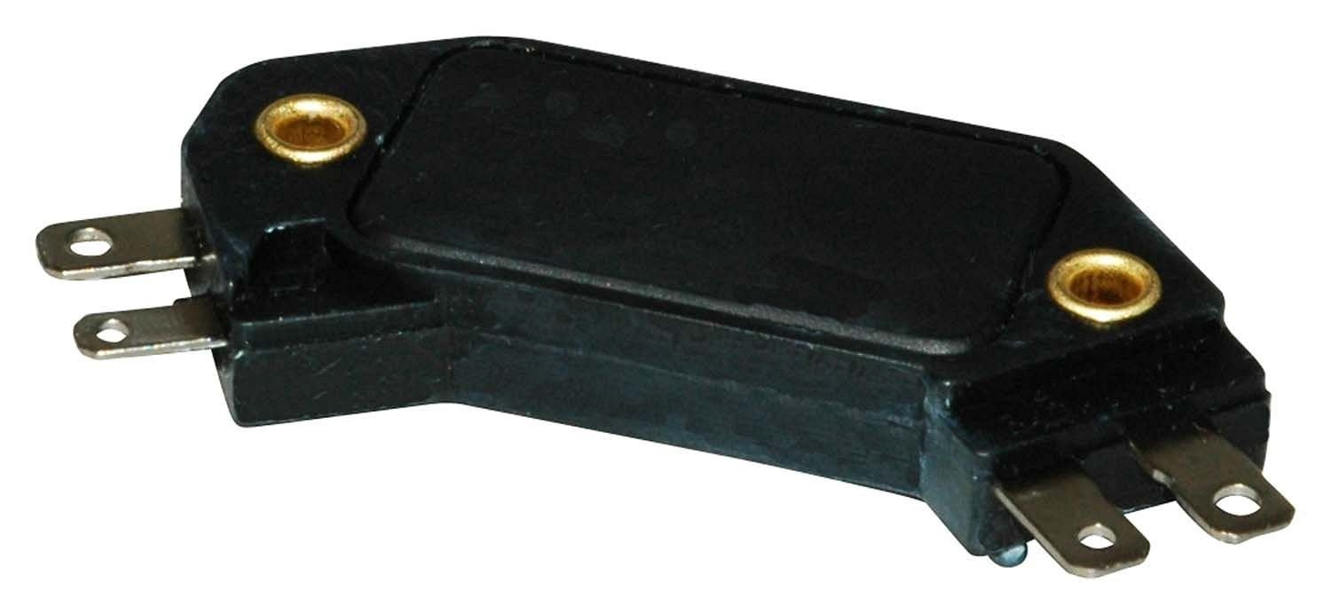

Ok, totally rebuilt the carb, looks great! During the disassembly I noticed this white sealant around the accelerator pump gasket. I figured it must have started leaking at some point and the PO just used it to stop the leaks. Well then I took off the pump and found this on the inside.
Hours of cleaning and vat soaking and high pressure air got it all out.
The bad news is the problem with missing is still there, going to replace the HEI pickup unit today, will update later.

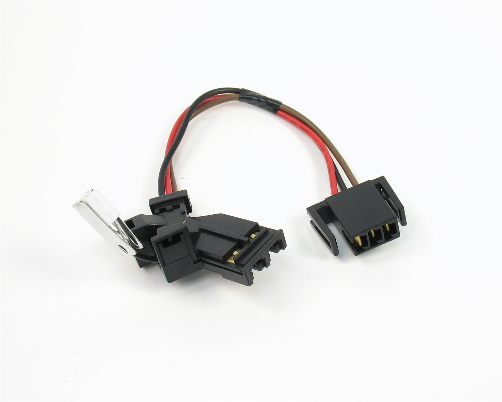

No power brakes, for testing purposes I also disconnected the pcv and plugged the vacuum.
I installed the new HEI igniter and connector, it got worse. When I try to get the engine to idle I get backfire from the carb and exhaust. Adjusting the distributor to the passenger side lowered the rpm, turning it towards the drivers side increased the rpm as well as the back firing.
