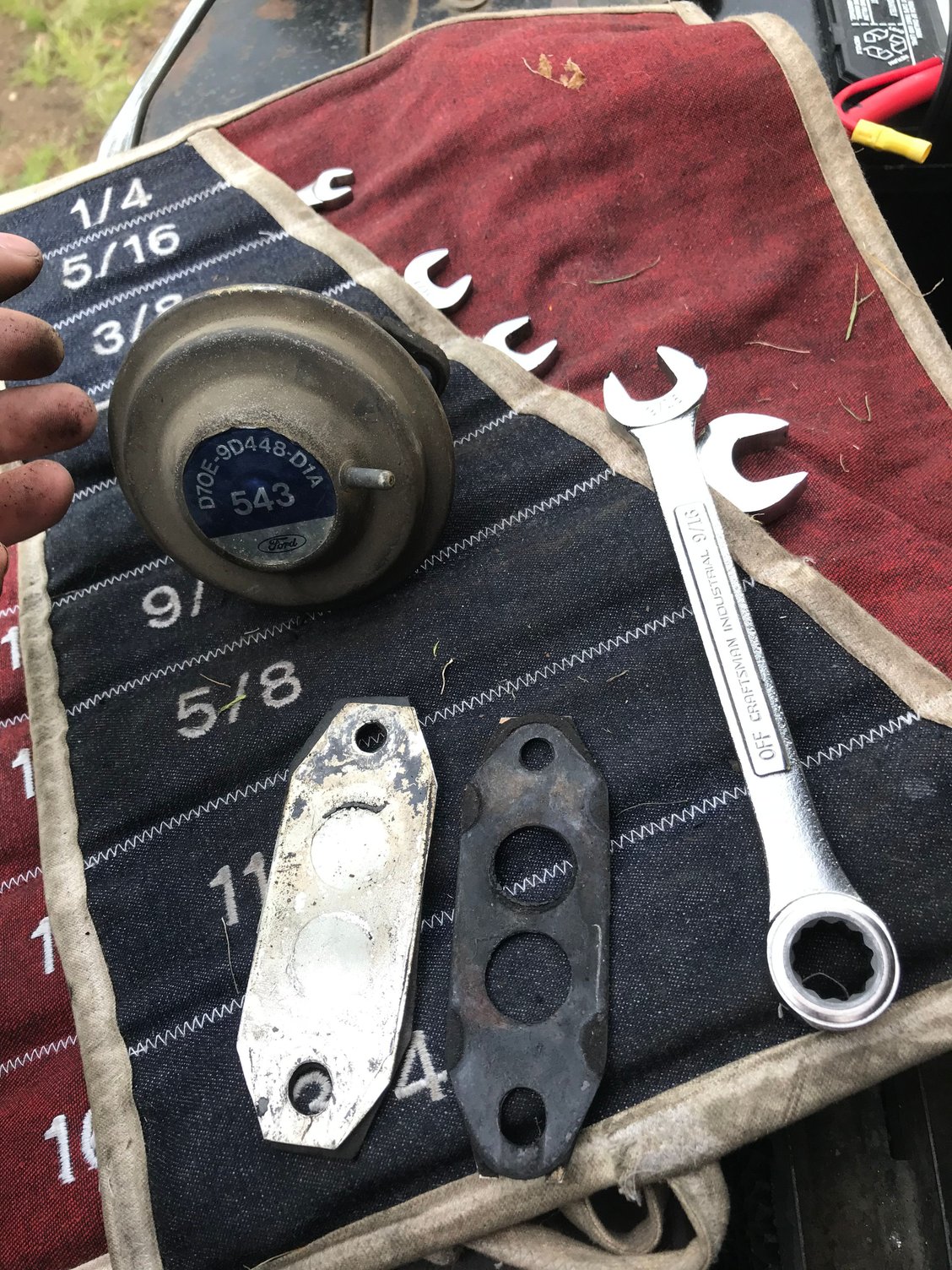

A guide online says if my EGR won't hold vacuum applied it needs replaced, should I replace it too?

Forget the EGR. No wait, take the EGR off, get a pop can or thin piece of aluminum and make a solid block off gasket for it, and put it back on there blocked off. There is a lot of junk on these engines that can cause problems, the EGR is one of them and it would be good to take it out of the equation. You are worried about it working, that is what you don't want right now. You need to be worried about it leaking, which they are famous for. That would mess up your idle.

I took the EGR off and it's already blocked off.

Good. Put the block-off piece back on there. If you have pinging problems, we can work on that later. But that is one thing out of the equation that could possibly cause idle problems.
