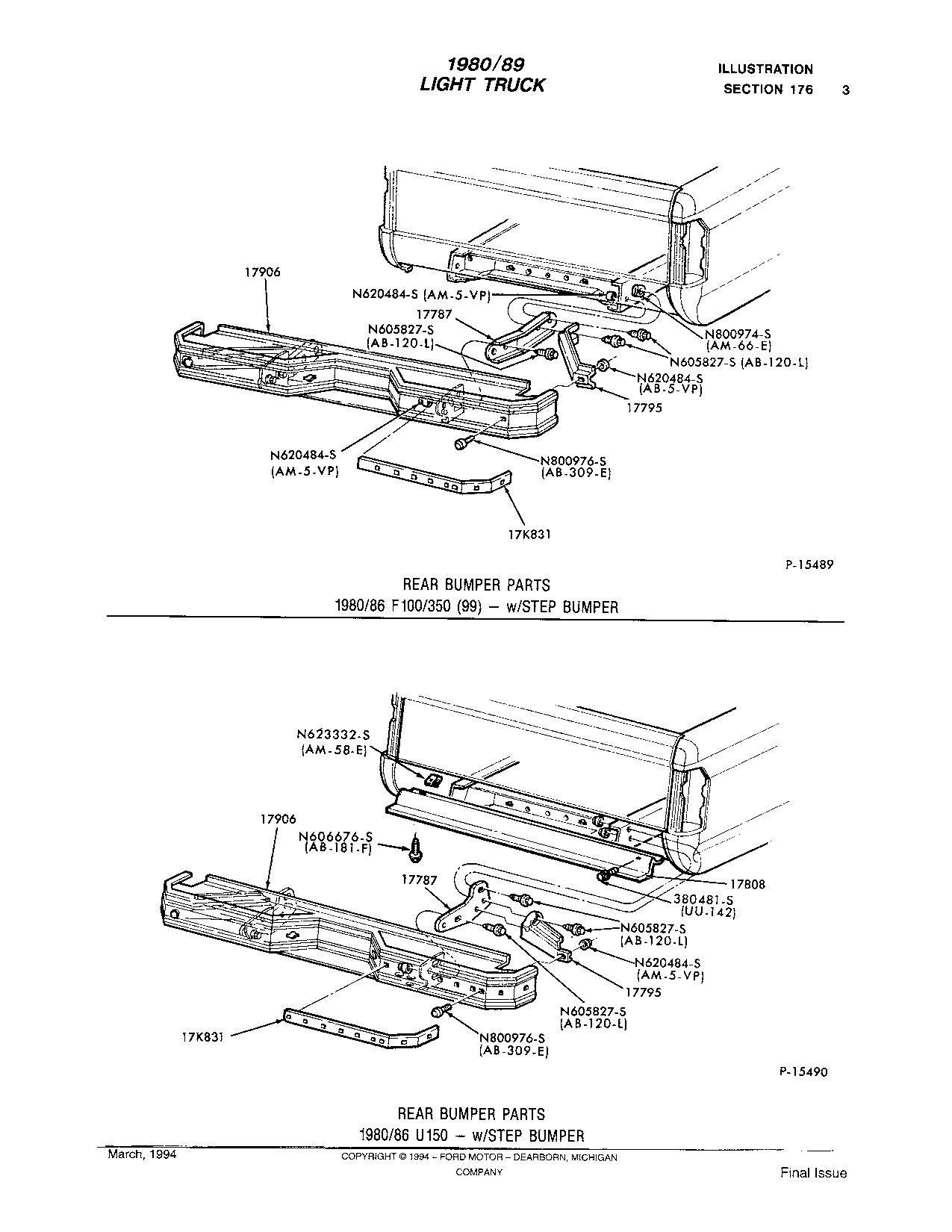

Upper pic: 1980/86 F100/350 Styleside step bumper. The vinyl bumper pads (17K831 right side shown) were optional.
