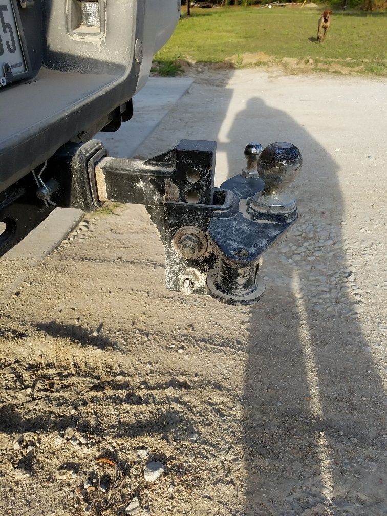

Ok guys, thank you for the response's. I emailed Gen-Y last night and received a call from there rep, we talked about what I was looking to do and he ask to send pics of the receiver that I currently have and will be using. There responce was it was ok to use My reciever in there Gen-y Stack as long as I shorten the overall length. So I will need to drill a hole to shorten the WDH so it will sit as close to the Gen-Y as I can. That is the route I believe I am going to try. Also I am going to Mod the 2 1/2 sleeve a bit to make the hitch much tighter so there is not so much play, some metal shims should do the trick.

My fix for the sloppy loose adapter was to go to the local truck bed weld shop and buy a piece of 2" hitch tubing. It's outside/across the flats dim is 2.5"...not 2.420 or so like the factory adapter. It has a reinforcing flange on the business end and the pin hole was the correct distance back the tube, allowing it to line up perfectly with the hole in the truck hitch once I cleaned up the flange welds a bit with a grinder. All I had to do was cut off the back end of the tube so that it didn't extend out the back side of the hitch and interfere with the spare tire. Cost was $26.
If a pic would help explain this, I'll go take a couple and post them.
If you have the 2 1/2" hitch why would you not buy the 2 1/2" GenY adapter to go in it???
You will need the increased capacity of the 2 1/2" shank anyway....
