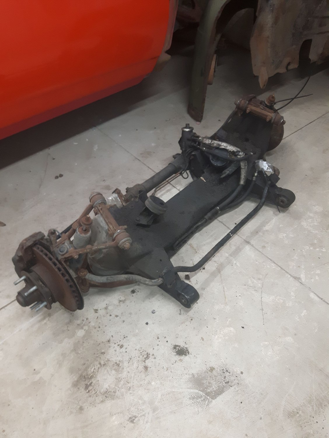

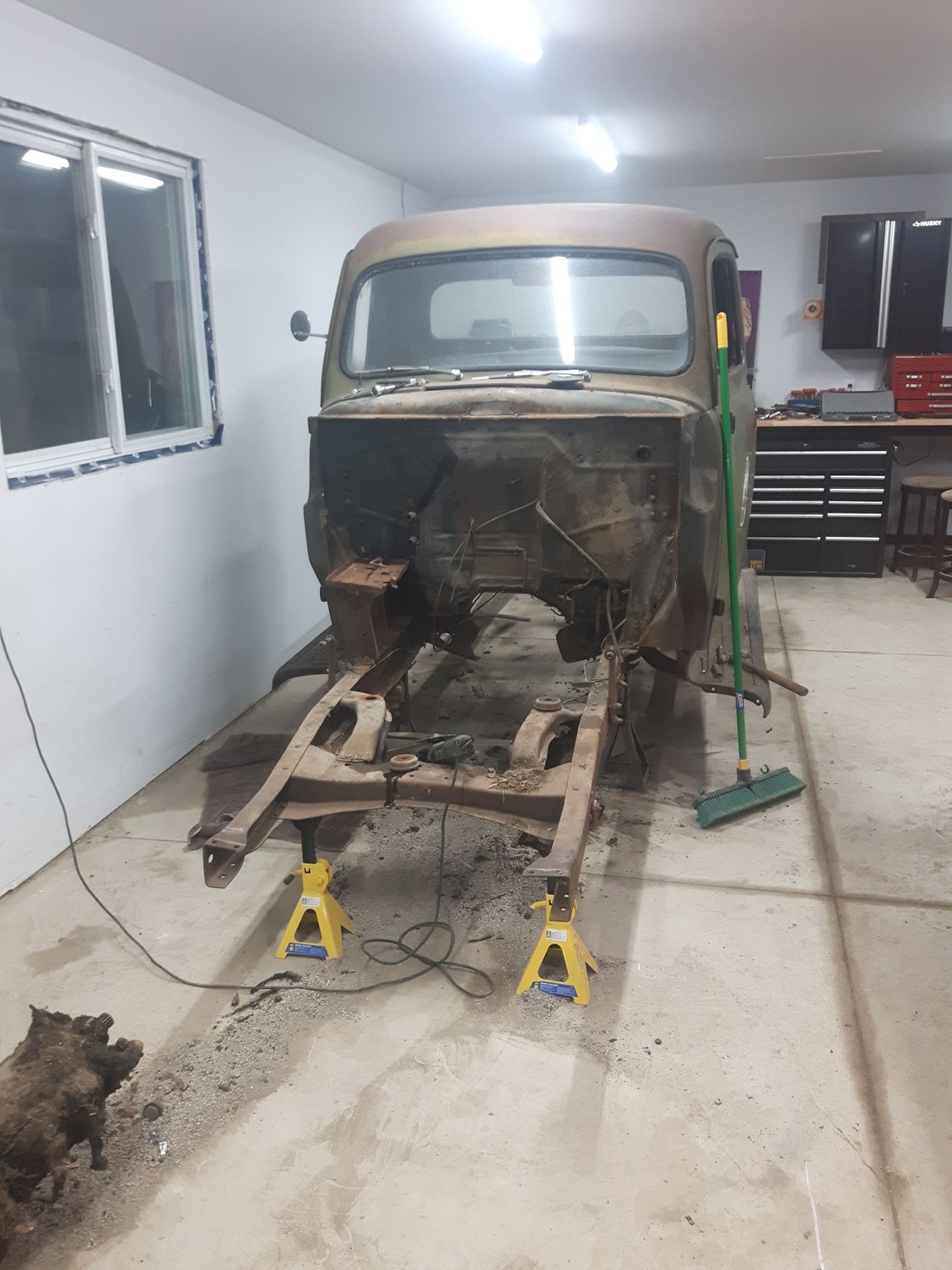

the front clip is out of a 1985 v12 jag.. was super clean.. i was checking out 70droptops post but all his pictures are gone... here is a pic of the cab on a frame i borrowed from my buddy a while ago just to move it around... he sold the frame before i actually got to working on my truck

Its much appreciated. I just set it at 21 1/2 and put 3 tacks on both side's for now... i am trying to borrow a fender off my buddy right now to hang it on and see if it works at that dimension..

Yes, that is a good idea. When I fitted my jag front up, I used the previous Mustang II mounting position to locate the new front. We set it up and put the fenders back on and it looked perfect.
After the springs settled a bit, you can see in this picture that it is too far forward. Just clears the fender, but doesn't look quite right.
