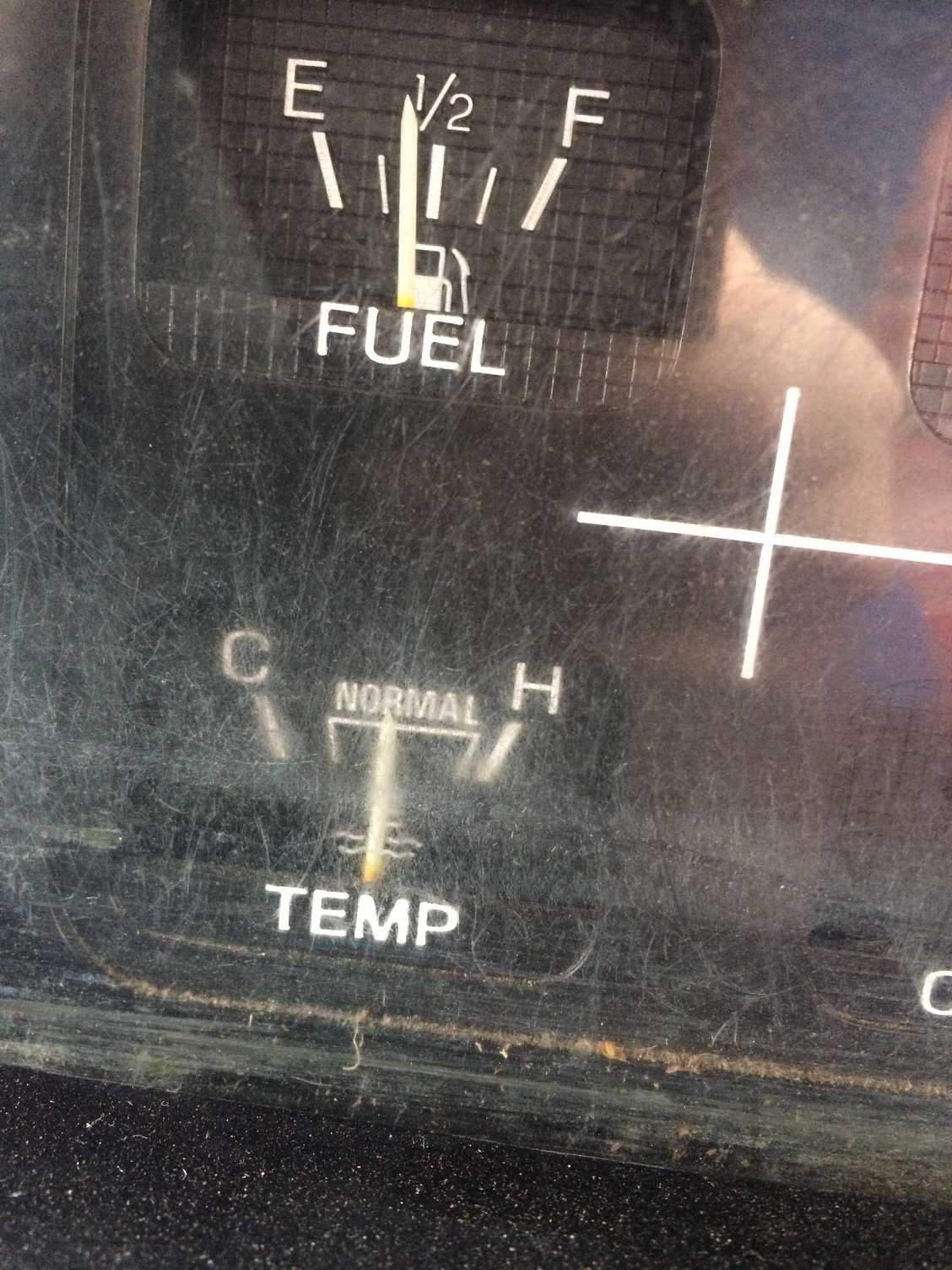

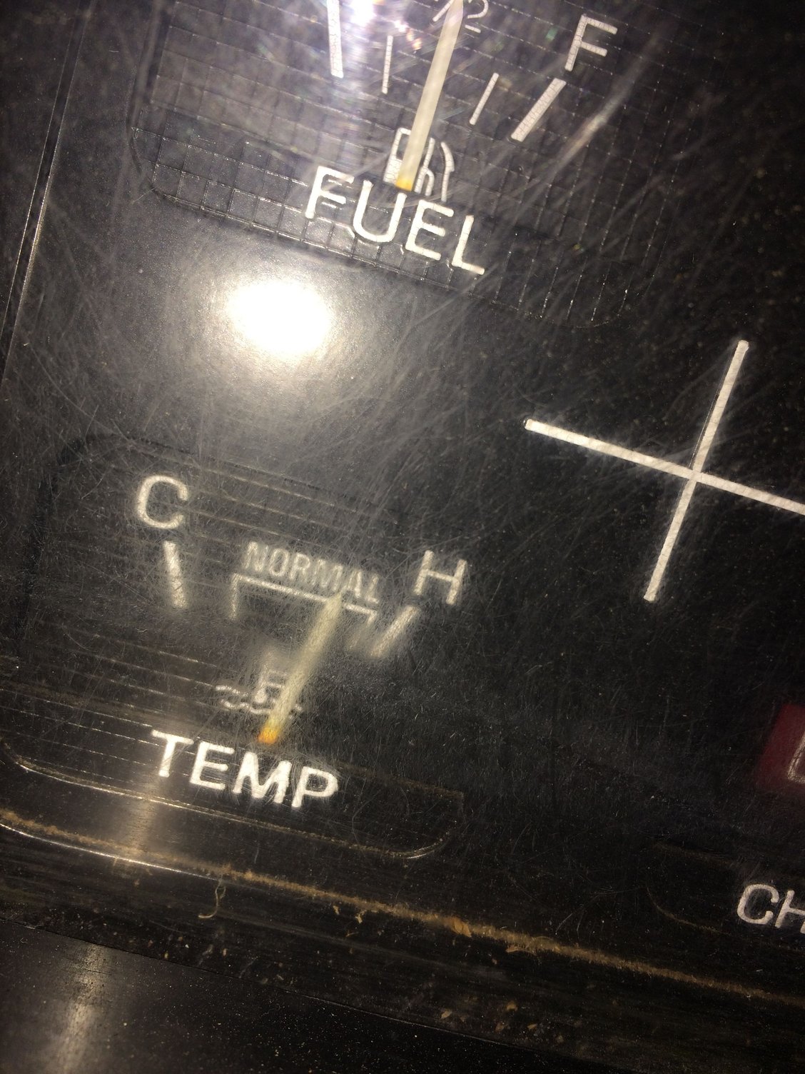

So I’ve been daily driving my 1981 F100 to and from work each night. I had a thermostat stuck in the open position. Replaced it with a 195 degree unit. As I was driving to work tonight, I noticed the temperature gauge read on the A on the NORMAL lettering. Is this getting too close the the red zone or is this acceptable? I noticed once I stopped, the gauge went down to the M. Where does your temperature gauge fall?

This is where it sat at all the way home this morning.
My truck does the exact same thing. I mean EXACTLY.
I also run the stock 195 degree thermostat. Normally, my truck runs right where yours is - around the "R." At times, the needle will slowly climb to the "A" just like in your other picture with nothing else being different. I put an infrared gun at the thermostat housing during both conditions, and the actual temperature reads the same! I am not sure why the gauge reads differently, but know that mine does the exact same thing and there is nothing wrong.

Thank you very much for replying. Glad to know that my old truck isn’t the only one lol. It runs normal and acts fine. Just saw the spike and it kind of startled me.
