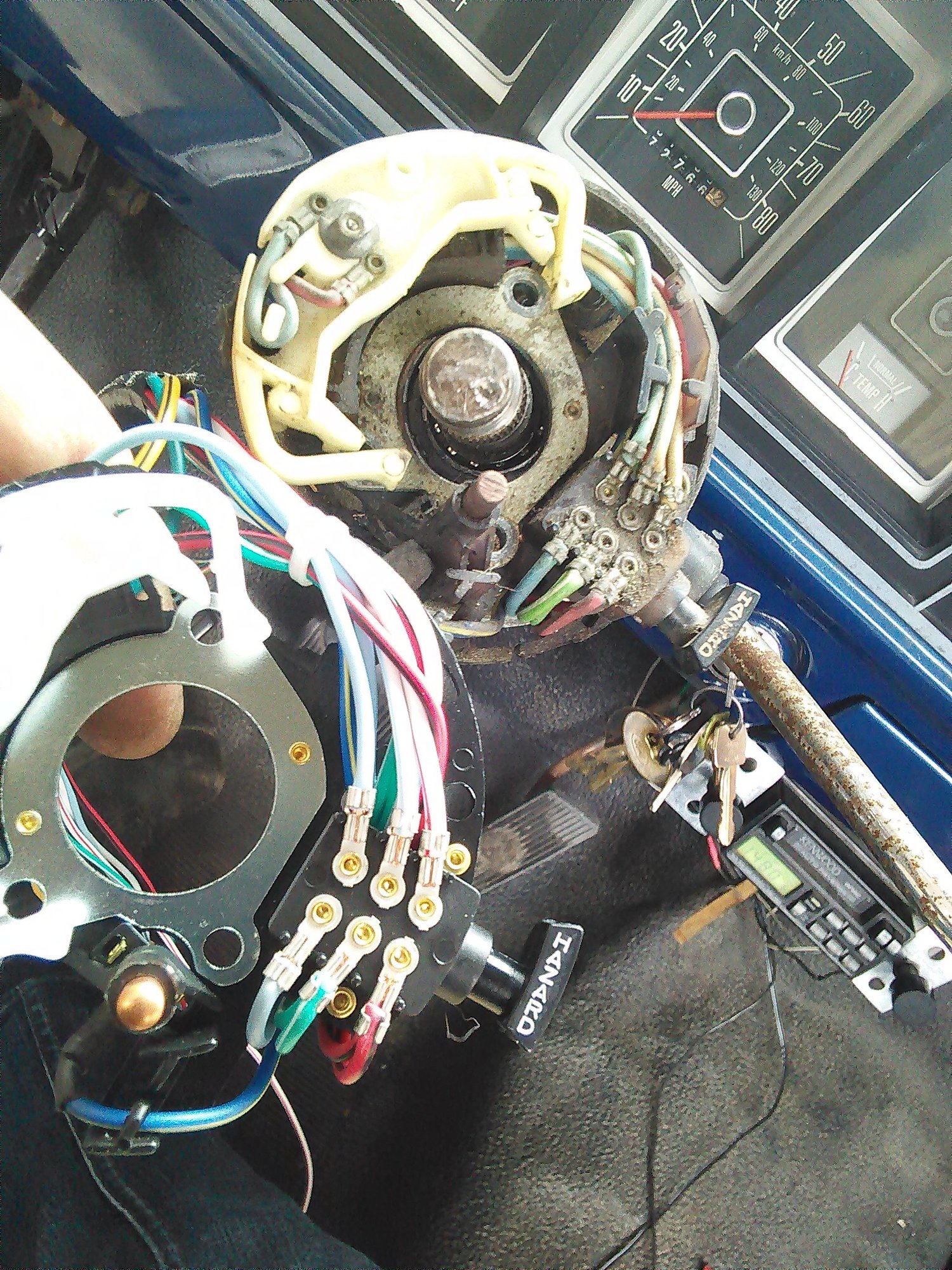

I hate to say it, but go back and double-check your pin placements in the TS switch connector. This just sounds like the kind of crazy stuff that happens when a wire is in the wrong spot - more explainable than the crazy stuff which occurs due to a missing ground... Guess yours is different with the automatic, but I wouldn't be surprised if all of the MT wires are in the same positions on an AT switch, with the PRND21 lamp added to an empty pin position. Is the gear indicator lighting up?

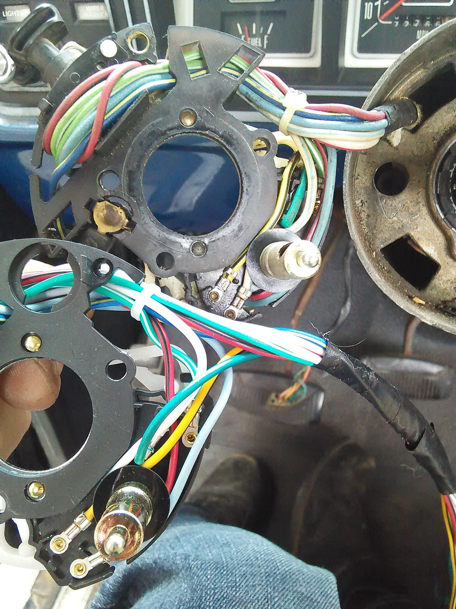

Here's my MT switch:

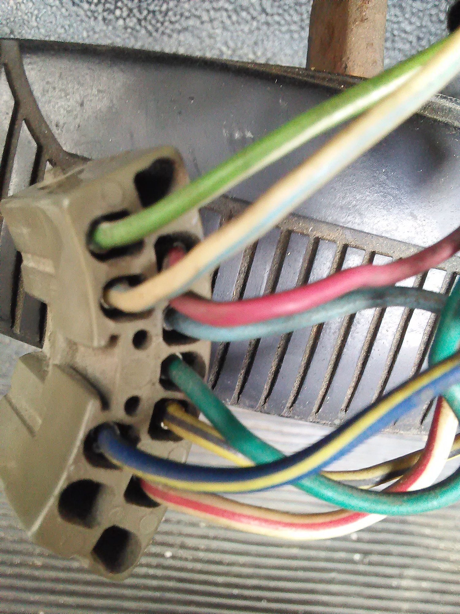

And here you can see where a couple of the wires on my new switch are a slightly different color from the ones in the original:
Those greens are different! The old switch uses lime/olive green wires and the bright green wires. The new one uses the bright green in both runs, leading to potential confusion. There is a stripe on one of them to differentiate them, but easy to overlook with old eyes...
