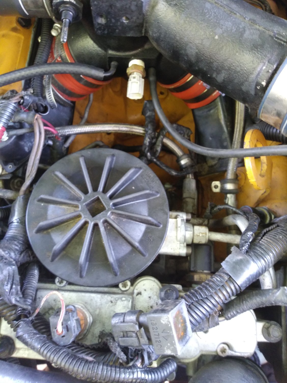

If it looks anything like this you have a late model 7.3 fuel filter housing.
i converted my OBS to late 99 superduty everything, turbo, spider, plenums, up pipes, front timing cover, etc.
