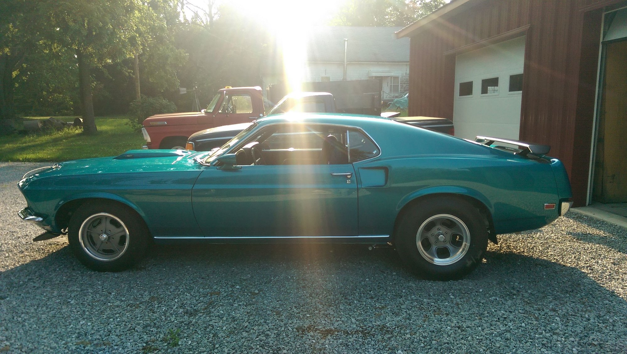

This may be a truck forum but going by "69 cjshaker", I'd like to see pics of that car.
Well I hope this doesn't get me in trouble, but since my truck is in the background, maybe I can get away with it..lol
The shaker was removed for the 2x4 intake, but it's an original R-code 4spd car. I've been a member of the FE forums forever and driven bumpsides for the last 25 years.

AWESOME. That got my Ford Blue blood up.
Thanks for posting.
