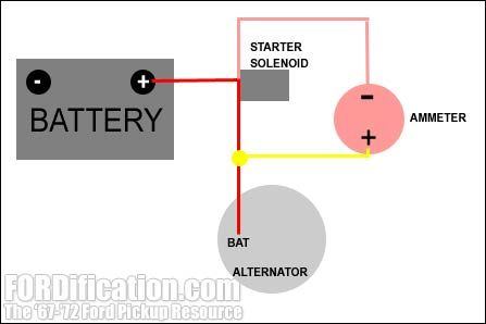

Mine seems to work fine:

@rowdyredneck, I converted my 81 Bronco cluster to all gauges back in 1985 and after blowing up two amp gauges I realized I needed to install a "Shunt" the amp gauge gets positive on both sides. (#1) one side to the battery side of the solenoid and the other side to a wire that connects from your Alt Charge wire to to the same location as (#1) the other wire to your amp gauge connects in the middle of the "Shunt" and displays the imbalance of the two.. Just-Sayin.. CROZ..

Gauges from Lights
The nice thing about the conversion was aside from having to install a Shunt for the Amp gauge, all I had to do replace was the temp & oil sensors with the one for gauges and run the Tach drive wires..
