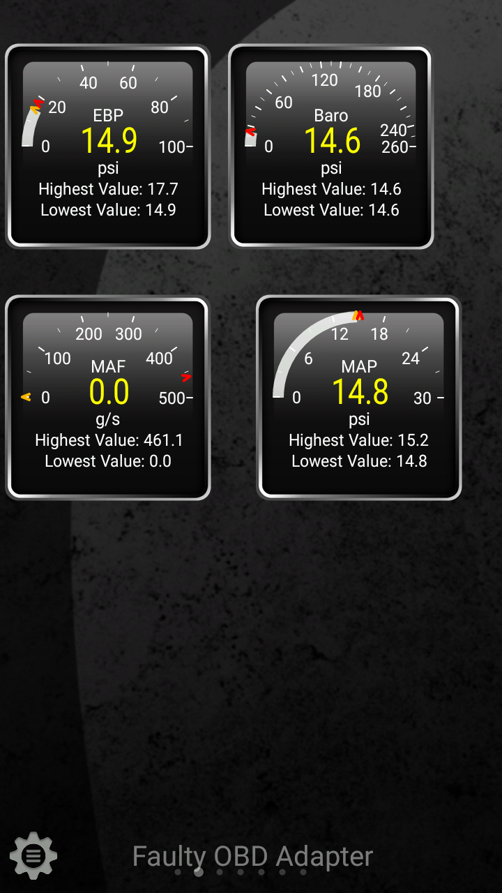

Originally Posted by bismic
Do you have an 03 engine in your 04 (check by the ICP sensor location)?
EBP sensor clean, tube clean? MAP hose in good condition (not plugged up and no holes in it)? What are the EBP, MAP, and Baro readings at KOEO?
VGT connector on tight?
Here are the readings koeo . I haven't inspected the ebp sensor.

you didn't post enough sensor data to determine a Bad Sensor yet
Baseline looks ok
more info
