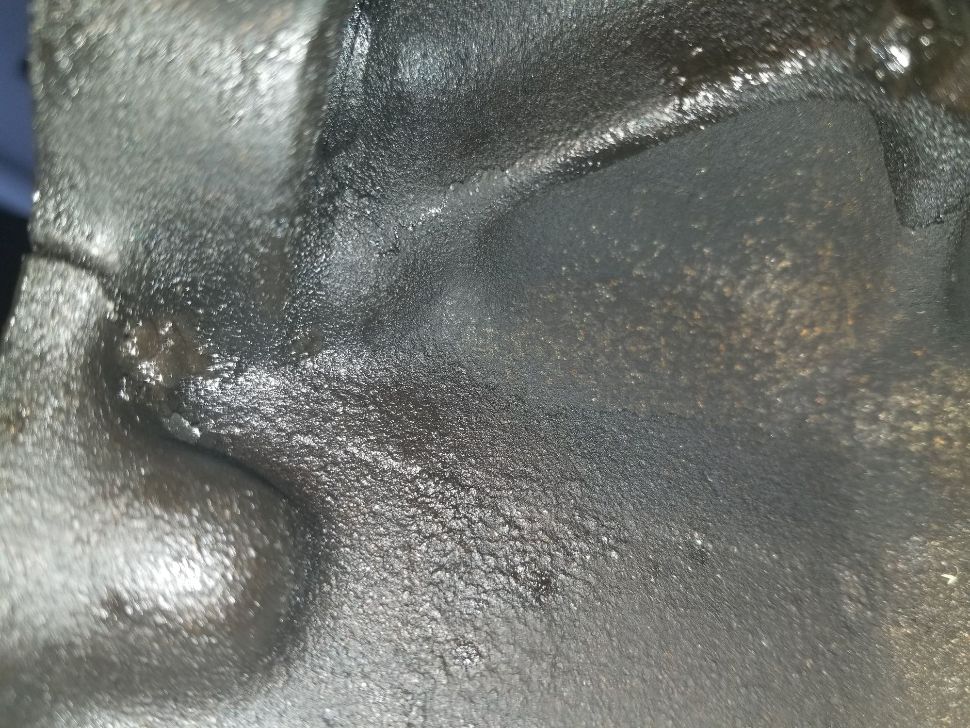

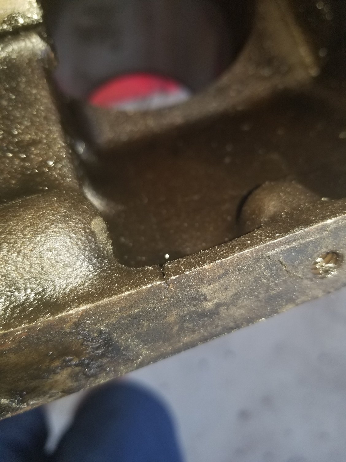

I Have what is believed to be a 360 pistons are stamped with that and I can't find any reliable casting Mark's. My crank only has an x stamped on it and the block has an x and a 307 tag (in the pics) and a backwards 50i by the looks of it.... please help and also in the pics I took pictures of what I believe is a cracked block?

It's a mirror 105 block. 360 and 390 both share 4.050" bore, the latest blocks were the 105's and thought to be a little better. I can't recall if mine had the X like that or not. I can't tell if that crack is anything or not.

That crack almost looks like a casting flaw. I'd clean it up and see what you actually got there.

From the picture of the crack, it does not look threatening. I would clean it up like matthewq4b said.

Agree on gettin yer block squeaky clean....how can you follow the boogeyman when you can't find the tracks?
