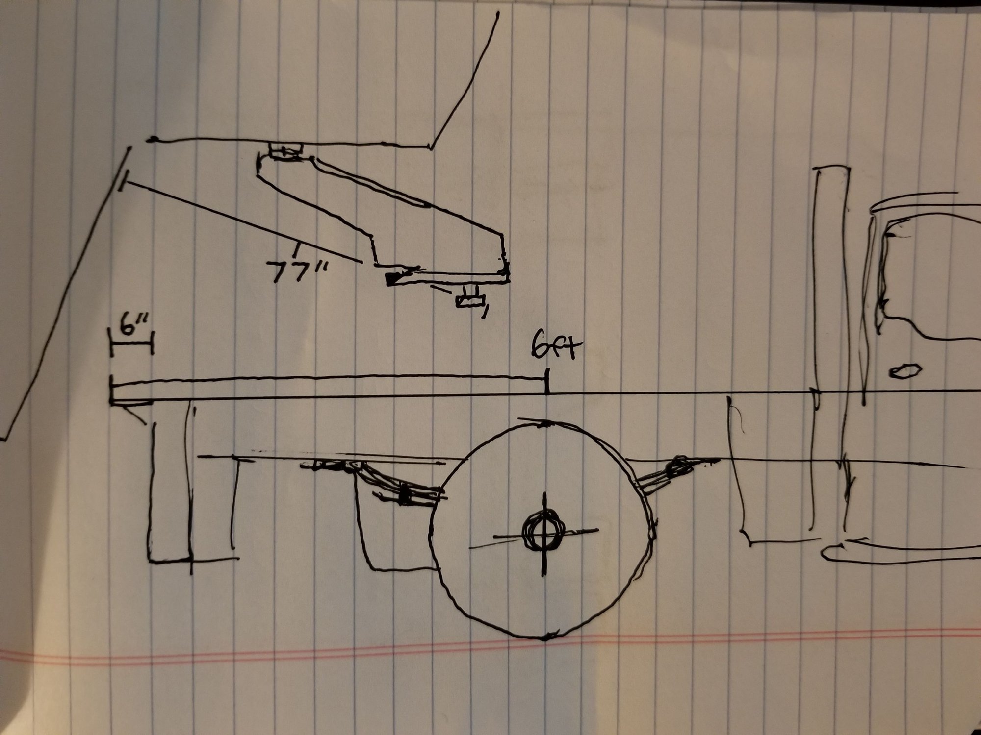

Point me at a grinder and blade you would recommend (Amazon will work). I get what you mean by using the cross member id want to dog-ear it also if I'm cutting. actually the nice thing about cutting is i could probably just get away with trimming the blade off the 6-inch blade and then dog-earing the corners.
maybe these caveman drawings will help, this is what im working with.

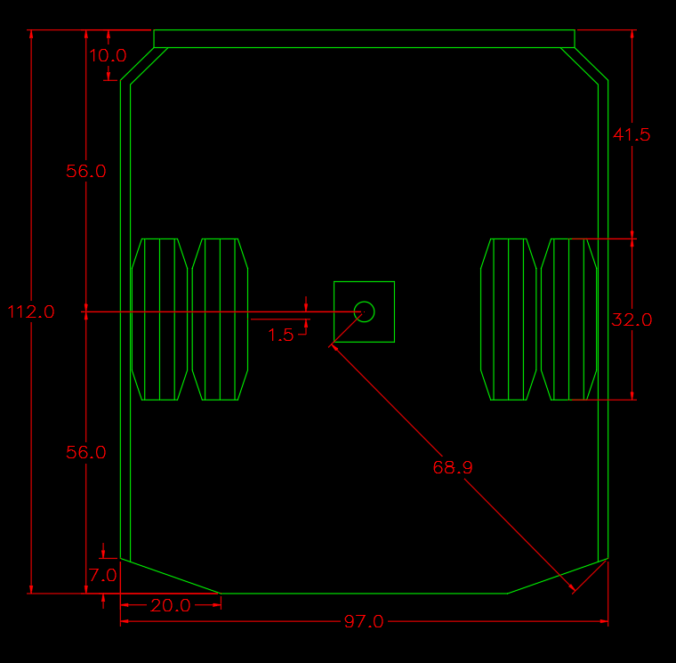

Here is a sketch of my bed. Do you want a fifth wheel or gooseneck ball? Keep in mind if you want to mount a fifth wheel or gooseneck hitch to the truck frame you are on your own. I could not find any bolt on kits for the older chassis cab trucks. Not a problem but not a 2 hour no drill installation with basic hand tools. Keep in mind the height of the fifth wheel hitch. If you cut down your existing bed and bolt a fifth wheel on top it will need to be very short.
I was going to do something like this but with a light duty bed and after looking up a hitch, fenders, lights, and some lumber for the bed it was cheaper to buy a new flatbed I found onsale at a dealer.
Originally Posted by Brock Samson
Sans-bed??
How often, how far, and how heavy are you towing? Here are a few options.
Leave the bed alone. Mount the fifth wheel hitch about 2 feet behind the axle. (depending on the answers above)
Take the bed off. cut off 18 inches from the front of the bed and trim the rear corners. then move it forward. This leaves your rear hitch intact. This assumes you can move it forward based on how the rear of the bed is constructed. 56 inches from the back should put your hitch directly over the axle to 2" in front of the axle.
