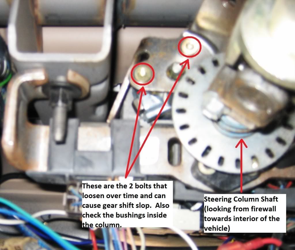

No matter what the DTR does it CANNOT prevent it from going into reverse. Reverse is hydraulically selected, not electronically. If the manual valve is moved to the reverse position it doesn't matter what the DTR does. A better thing to spend time checking is the two bolts that hold the shift bracket to the shift tube. They are located at the bottom of the steering column. If they come loose, you may not be moving the manual valve all the way to the reverse position.

Mark, I've checked the bolts on the steering column and I've torqued the feed bolts and valve body bolts to the published spec. I dug up an old post where you told a guy it might be the seals on the reverse clutch going bad. Do you see that as a likely cause here and is that something that's likely to leave me sitting? Or more likely something that will gradually get worse until reverse no longer works? Or impossible to say?
