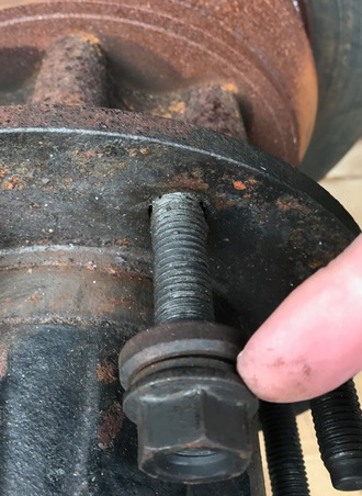

So, I'm on the home stretch, and just wanted to confirm something you wrote about earlier. I have a fair amount of rust on the rotor hat (I think that's the right name for it, but the picture will make it clear). I started with a wire brush by hand, but it was slow going. I have a wire wheel for my drill, so I decided to put that to good use. It certainly is much quicker, but I'm wondering if I'm taking the easy way out. I'm taking a brake from the humidity, so I came inside to re-read your last post to me, and I noticed all of your pictures have you doing the work by hand. Should I switch gears and head to the hardware store for some heavy grit sandpaper and scouring pad? I'm trying to be sure I'm only applying light pressure with the drill, and I'm spinning away from the caliper. I can't see the rust particles flying off the rotor hat, but they should be going away from the caliper.
Also, when finished, should I apply a very thin amount of anti-seize or silicone paste to the area I'm currently sanding, or should I just remount the wheels dry?
And final question about wheel assembly. In the second picture, I think I'm pointing to the spot that you said needs a drop of motor oil, but if I misunderstood, could you correct me?
When torquing down the lug nuts, I know to use the star pattern, but do I go to 165lb directly, or would it make sense to get every lug nut to ~90, then ~130, then pull out the torque wrench for a final twist to 165lb.lbs, Sorry for the simple questions, and that's why I need to thank you again for your patience. I definitely respect your knowledge, and and since I'd like to do this job right, I don't mind looking like an idiot as long as I'm taking good care of my truck. Thanks again, Tom

Powered is fine if you want to clean it, but it will rust again. The lug nut oiling location iscorrect, antiseize on the hub pilot, and we did the Superdutys in a stepped torque similar to your values. I had the guys go in a clockwise direction, every third nut. Three trips around the wheel for each torque step.
