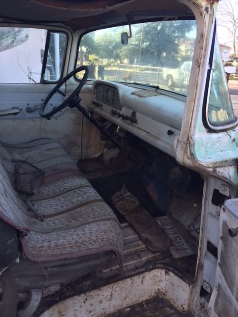

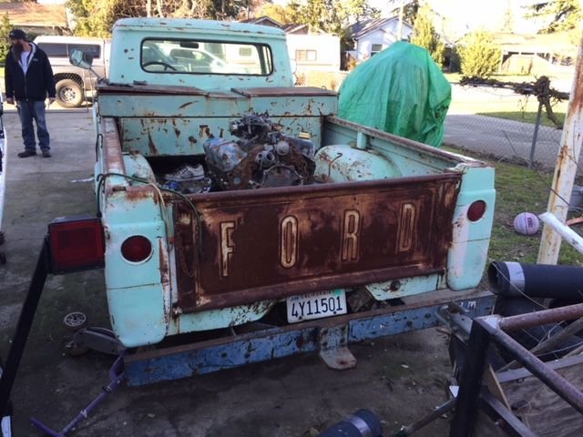

This is the start of the project F250 long wheel base and the motor was in the bed. I've already started on this and will be up dating it soon.

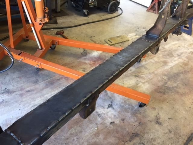

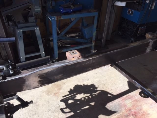

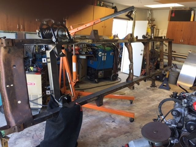

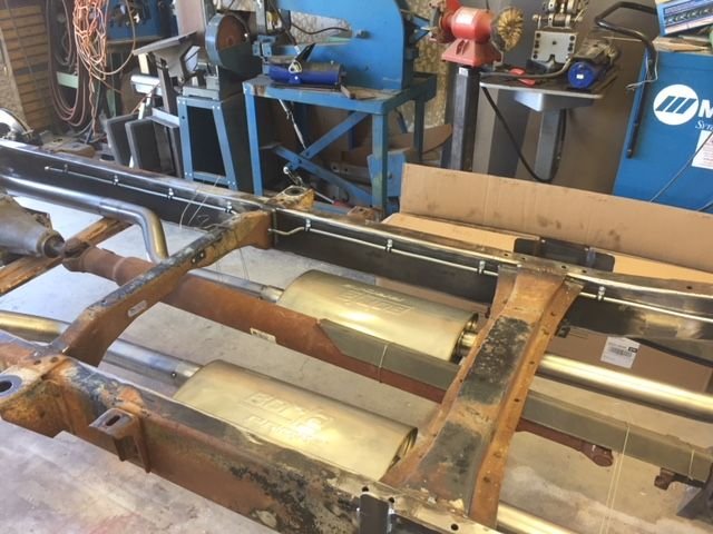

Brought truck home and tore it down. Boxed in frame and added Mustang 2 front suspension. Also added Ford 9" rear end

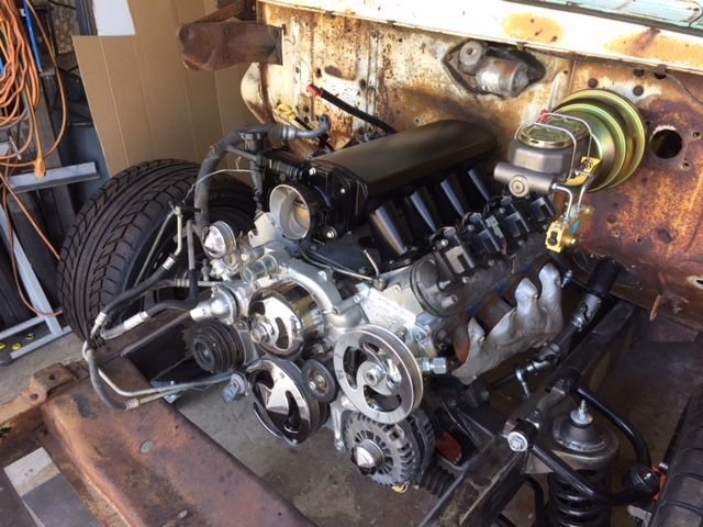

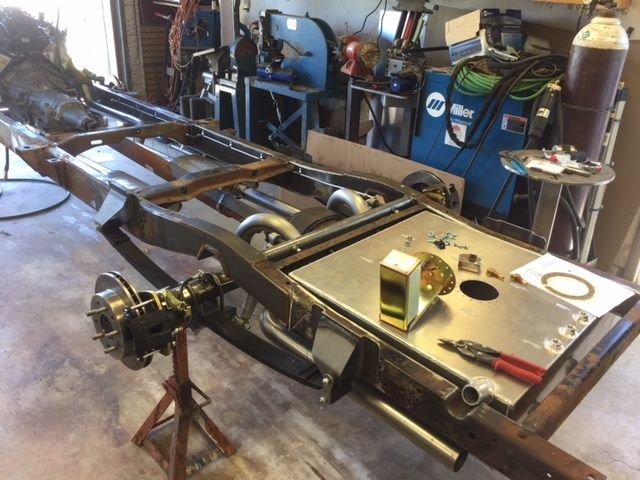

Motor and trans mounted in position Fuel tank in .

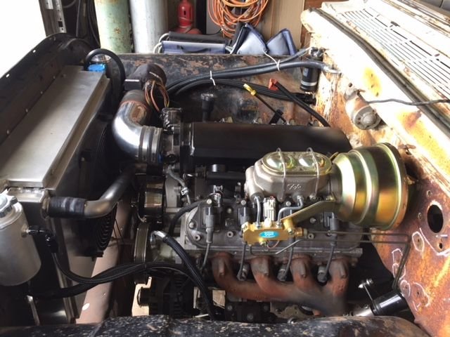

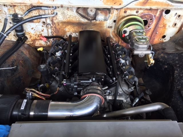

Motor in, using an LS Went with that had a lot of spare parts This is a budget build I have a target i'm trying to keep it under.

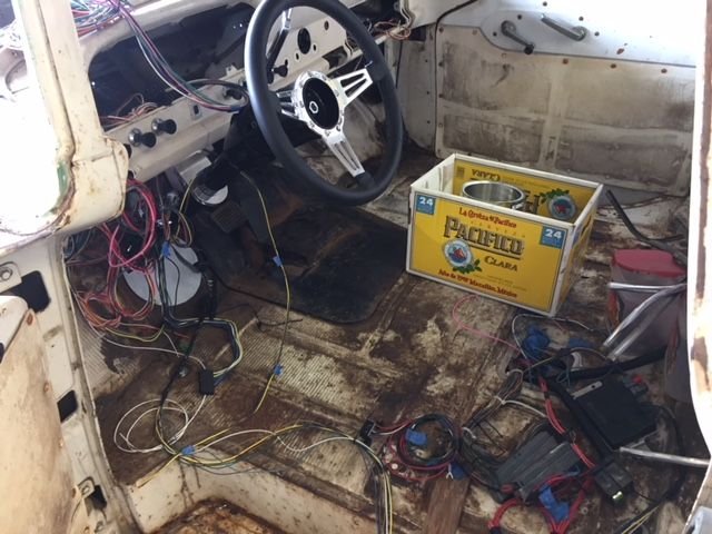

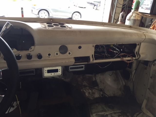

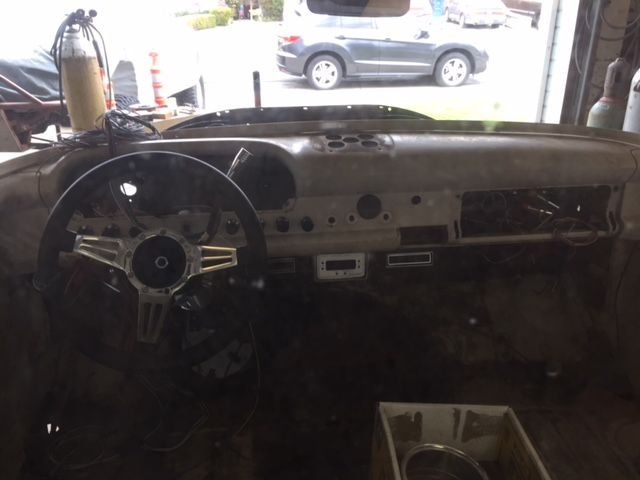

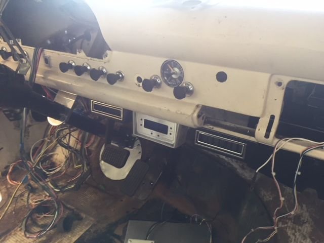

A few more pics. Added Vintage air Went with Dakota digital climate control center lower dash New wiring going in the ECU. will be under the seat. Also keeping stock radio in dash as all the ***** too. Only major change is the gauges
