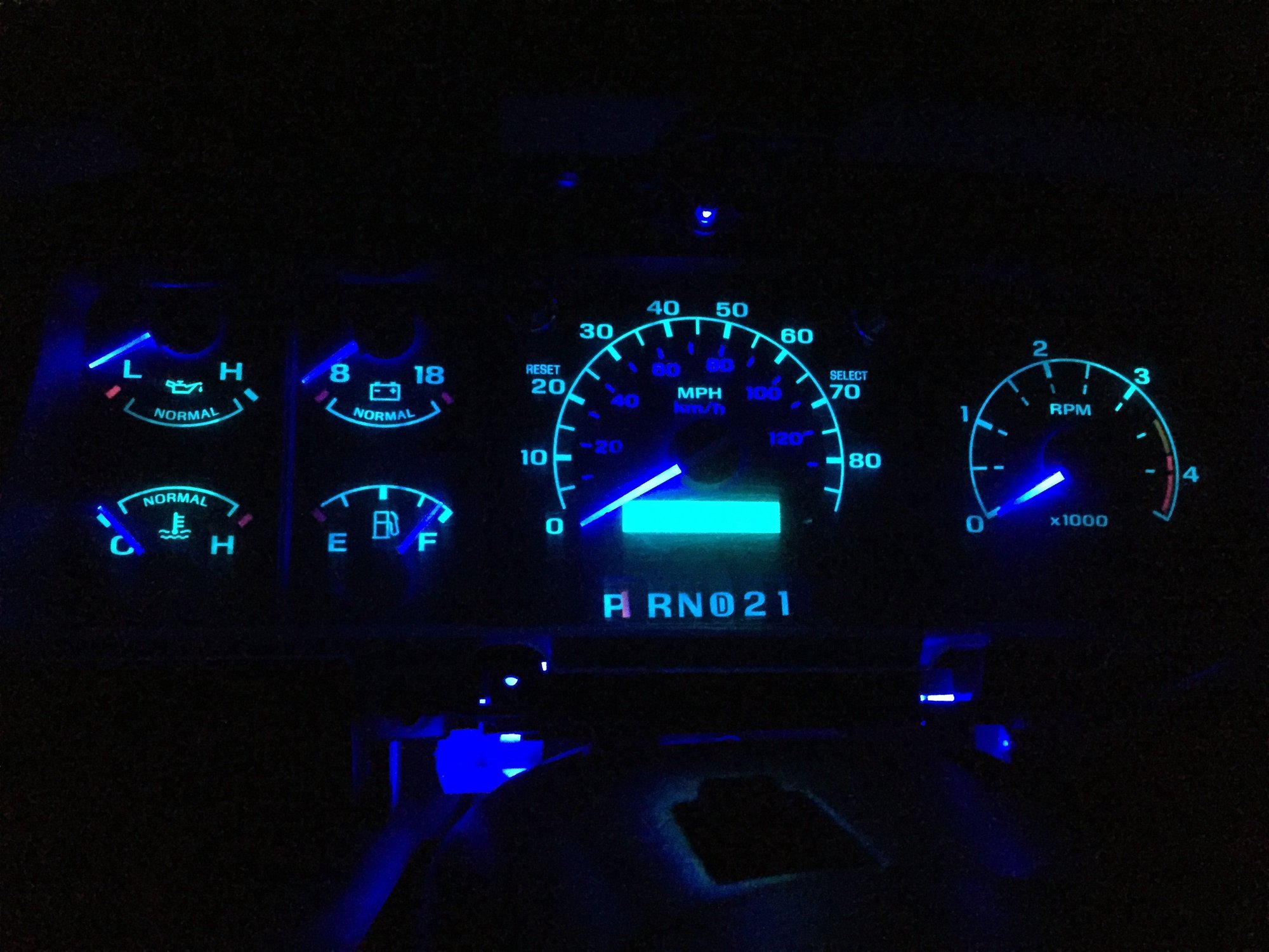

Here’s a pic of my dash with the new leds. I am not to crazy about the green.

?? Don't know, not the same bulbs I used? They don't look as bright as mine in the pic above.Mine dim down but not as low as the stock incandescent bulbs

I think he problem with the bulbs I used is that they only illuminate straight out. The ones you used illuminate straight out and 360 degrees. But that’s just my guess
Looks like you need to scrape the green tint material off the back of the cluster as another person posted. Be careful so as not to damage it visibly.
