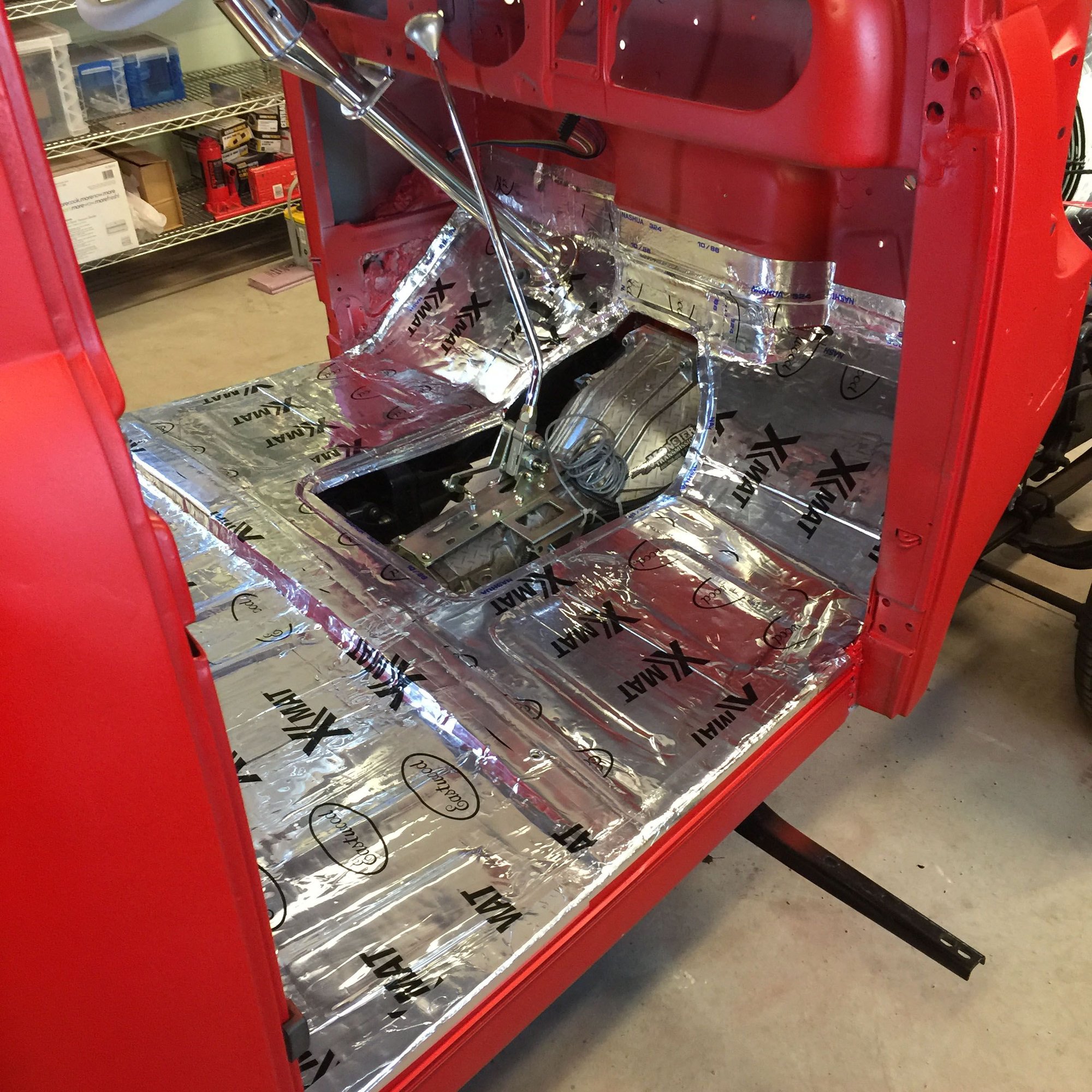

I don't think so. Here is the routing for my 1950 F2 as I received it. I think the F1 is the same.

Thank you for that. I will pull the floor mat up and look for the same hole.
Actually could anyone else back this up. Surely if the speedometer cable enters the cab enters the cab and runs up the inside of the firewall...won't the bend at the top to meet the speedo be to tight ?. I had assumed the cable would go out through the firewall adjacent the speedometer, then run down to the gearbox through the engine bay.

Mine is a 51 but should be the same. The speedo cable (and choke and hand throttle} went through the larger hole in the center of the firewall.

Good idea to check. That picture was taken in 2011 and a lot has changed on that truck since then. And a lot happened to it before I got it. Hope that I didn't lead you astray.
