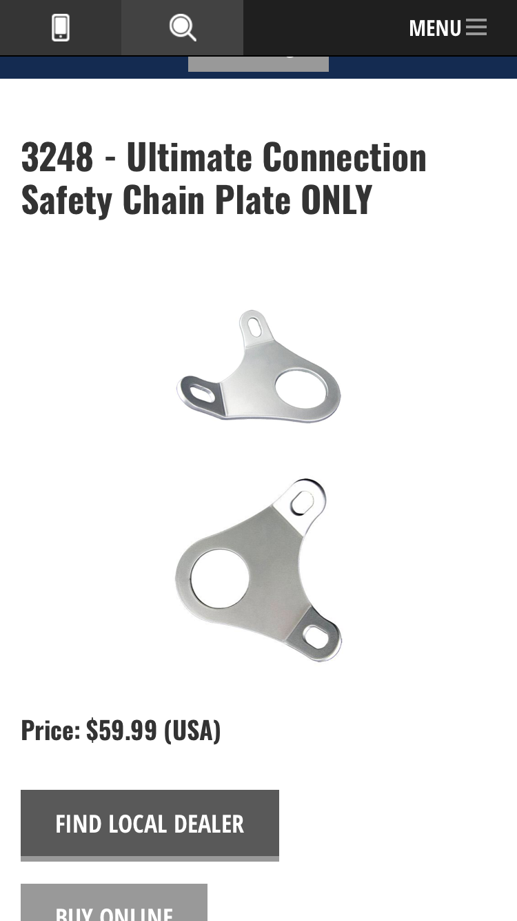

Originally Posted by Larrymac52
If you have a gooseneck attach to your AUH, this is another option for attaching safety chains instead of drilling holes into your AUH.
No gooseneck Larrymac. Thanks for the thought!
I was thinking I needed to buy a new hitch until I did some research and found the info on drilling the holes.
