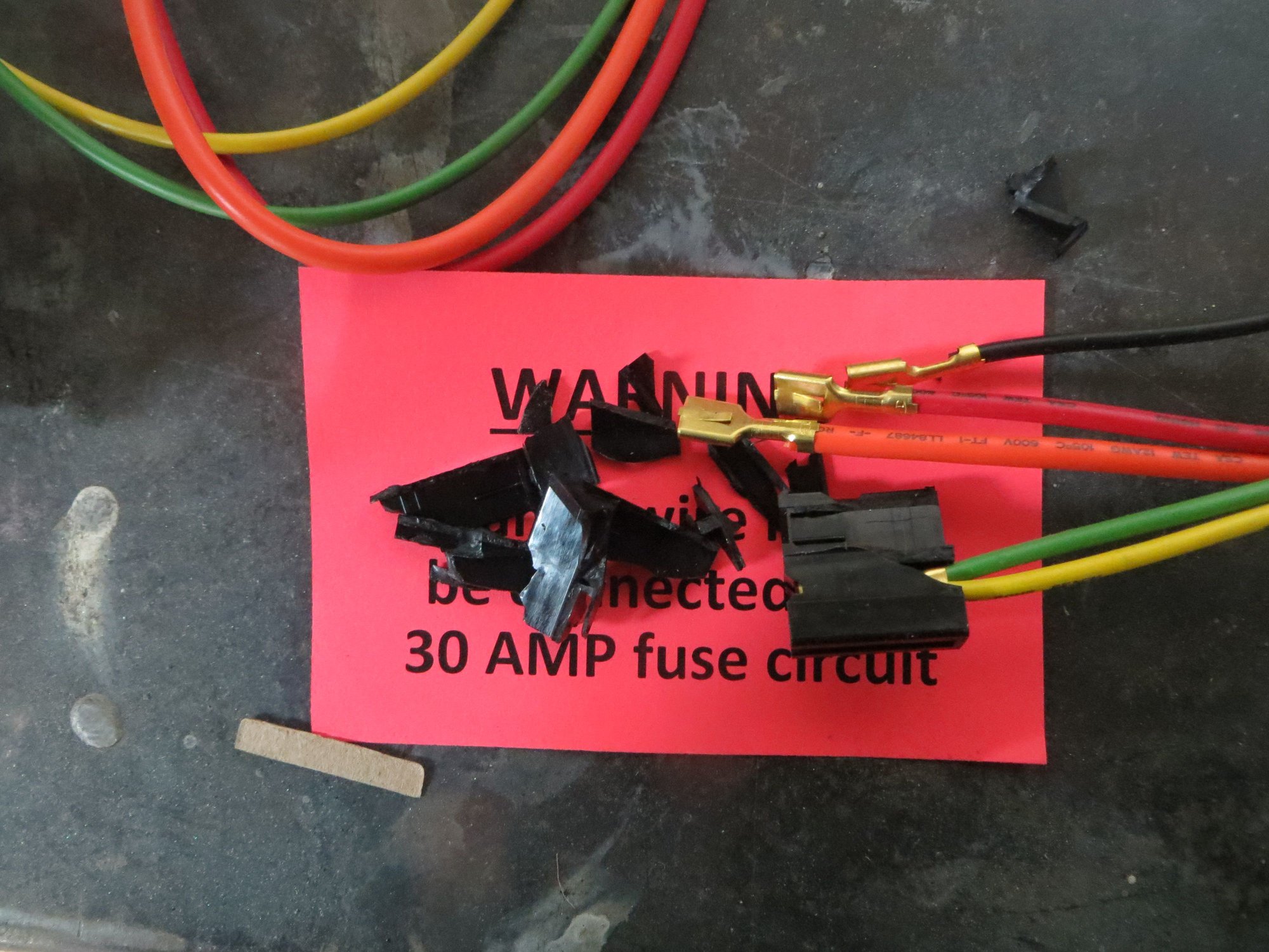

The only bummer so far, is this smashed plug-in for one of the relays, that I discovered upon opening the boxes. Hopefully the folks at Derale will send me a new one.

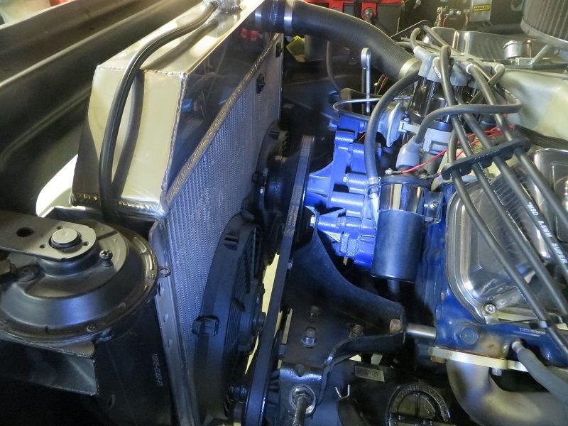

Here is my current set-up. You can get an idea of how close my water pump pulley is to the rad, and why I had to switch to electric fans.

The working area of the fans is really small compared to the rad area... Fab up a shroud so more air is pulled through when the fans are on.
'could also fab the shroud with openings and rubber flaps to release the rammed air at speed. The flaps will suck close with the fans engaged.
.02

I'm considering making a shroud. If I do, what is the best material to make it out of? Sheet metal? Aluminum? What thickness of metal?

I just got off the phone with Derale. I had to wait for the work day to start in California, you guys are 3 hours behind me. Super nice guy on the phone, my new wiring plug should be on its way by the end of the day.

I think aluminum is what gets used the most for making shrouds. You will ether need to tig weld it or if you have a spool gun for a mig welder that will work also.

I emailed Derale Performance yesterday. They informed me that they use AL @ 0.08-in thick. I was thinking of making my own shroud and was wondering what these guys used. I was planning to bent and weld (tig or mig) as needed.

So, my fingers are mostly better now, and my replacement wiring plug arrived from Derale, so I better get back to work. I mounted the fans to two 1"x1/8" aluminum straps, and mounted that to the rad. I temporarily hooked the wiring up to make sure it would all work. Hoooooly crap, are they ever loud!
