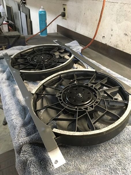

68murc's Avatar
68murc
Joined: Dec 2006
Posts: 881
From: Sudbury, ONT.
I took the fans back out and used foam tape to seal up all the edges that would be against the rad. This way, the fans must pull the air through the rad instead of around the edges of the fan housings. It took some doin' to get it back into the truck. The whole assembly had to go up from the bottom, the crank and water pump pulleys had to come off, the truck fought me a couple times.....Have you ever had one of those conversations with your truck that goes like this, "Listen you piece of ****, I'm trying to help you here. Why are you fighting me? This is going to make you better, why you gotta be such a bit** sometimes......"
Anyways, after getting it all hooked up, I let the truck run with the thermoswitch wire intentionally unhooked, to keep the fans from starting too soon. I let the truck warm up to 200, and then I grounded the wire and started the fans. Same as before, within two minutes, the temp was down to 170, and dropping. So, I think I'll go ahead and order the 195-175 thermoswitch.
