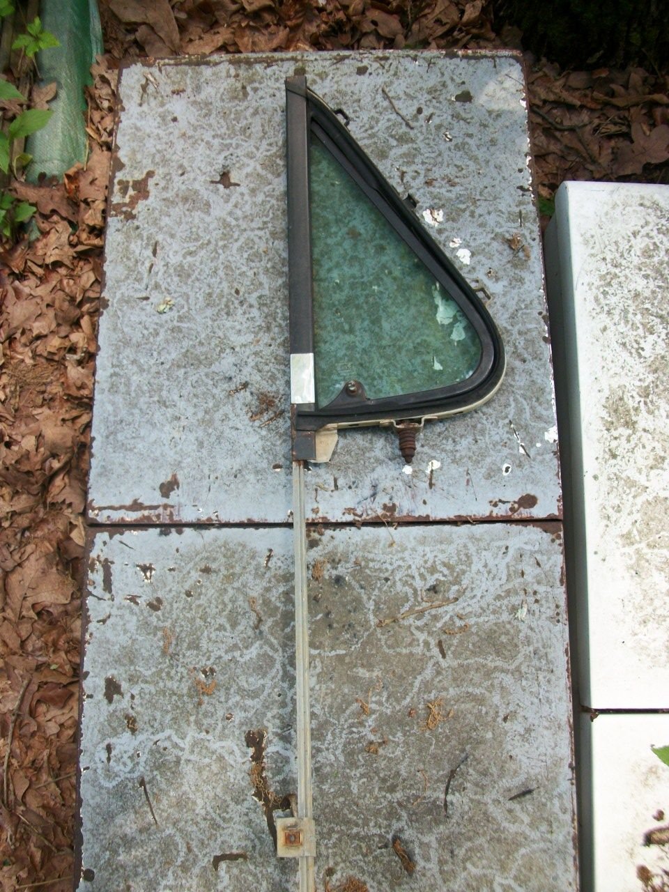

ok so i have a 1974 f100 and when i bought it the previous owner busted the drivers side door window out of it. i ordered a new window and it arrived today. i saw i had to take the vent window out to do it. is that just those three screws on the inside of the door? and also those bolts near the bottom of the door? my other question was that i had started to pull the vent window out and for some reason i started pulling the vent window rubber out(its pretty messed up anyways). is there a weatherstripping kit i can buy to replace the door rubber and the window rubber? also is this all i need to do to install the door glass? i tried putting the rubber back into the vent window tracks and it wouldnt seat right so do i need a special tool or is just because the rubber is old is the reason its struggling going in. thanks

Wing...screws on the door match the A pillar part, one bolt at the bottom of the division rail. JBG best kit IMO I use them.

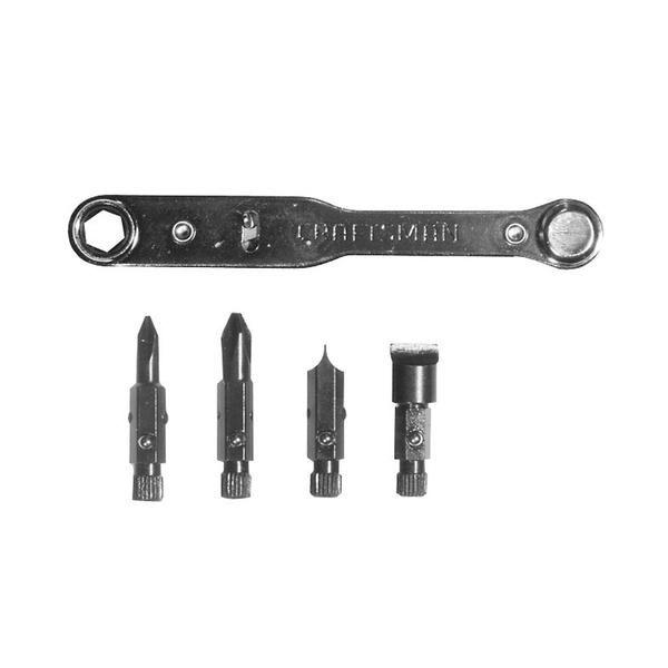

ok thanks guys. do yall have any tips on how to get that bottom screw out for the vent window on the side of the door? my screwdriver is too long so do you have to use a short one?

Yes with the door removed it was easy, do you have a stubby or a 1/4" ratchet with a bit holder or a ratchet screwdriver.
Sears Sears.com
Walmart : https://www.walmart.com/ip/Neiko-030...&wl13=&veh=sem
I vote for Jeffs Bronco Graveyard, who knows who made them or where they got them, but they fit great. https://shop.broncograveyard.com/Wea.../products/539/
