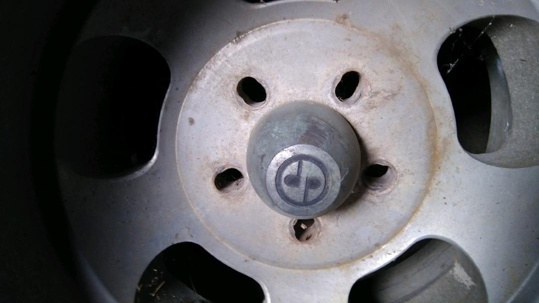

Aluminum slots
Any idea what nuts/washers these would take? The unilug im used to would take oval washers, these dont seem to have the indent for them.

Don't quote me but those lug holes from your pic look almost like the lugs came loose and wollowed out.
If they were uni-lug I believe they would have pockets for the oval washers.

Should be shouldered lug nuts with washers. I have some 70s Ansen rims like that my father bought new. They should be hub centric rims, the lugs just provide clamping force, they don't do anything to center the wheel. Those look like someone used tapered lugs on them, check for hairline cracks.

@speedfreak...Thats what I was thinking. Except the hub centered part. Makes more sense now, thanks.

X2 on looks like old unilug (pattern) hub centric (centered) rims and not lug centric (centered).
Ck Gorilla nuts.http://www.gorilla-auto.com/
Part #'s here, I am sure this link info is for an F250, so ck your F150 lug bolts. https://www.ford-trucks.com/forums/1...l#post14696886

Im an idiot, I learned a few things this weekend. Always bring a tape measure and how non et unilugs work. The pattern is ford car. I put them on craigslist, the fella text me asking if I wanted my money back....most wouldnt do that. Leason learned, I hope.

73-79 Ford truck 5 lug nut, 1/2 ton, F100, F150, 2wd, 4wd... pattern is 5 on 5 1/2. Having one of those lug pattern measuring plates is nice.

I thought that lug pattern looked small. Almost looks small enough to fit the old MOPAR 5 on 4.5 or whatever that is...

Ya, my dad called it from ten feet away when he seen them. I get my sights set and quit thinking. Anyway, that is settled. Im still looking for slots or turbines.
