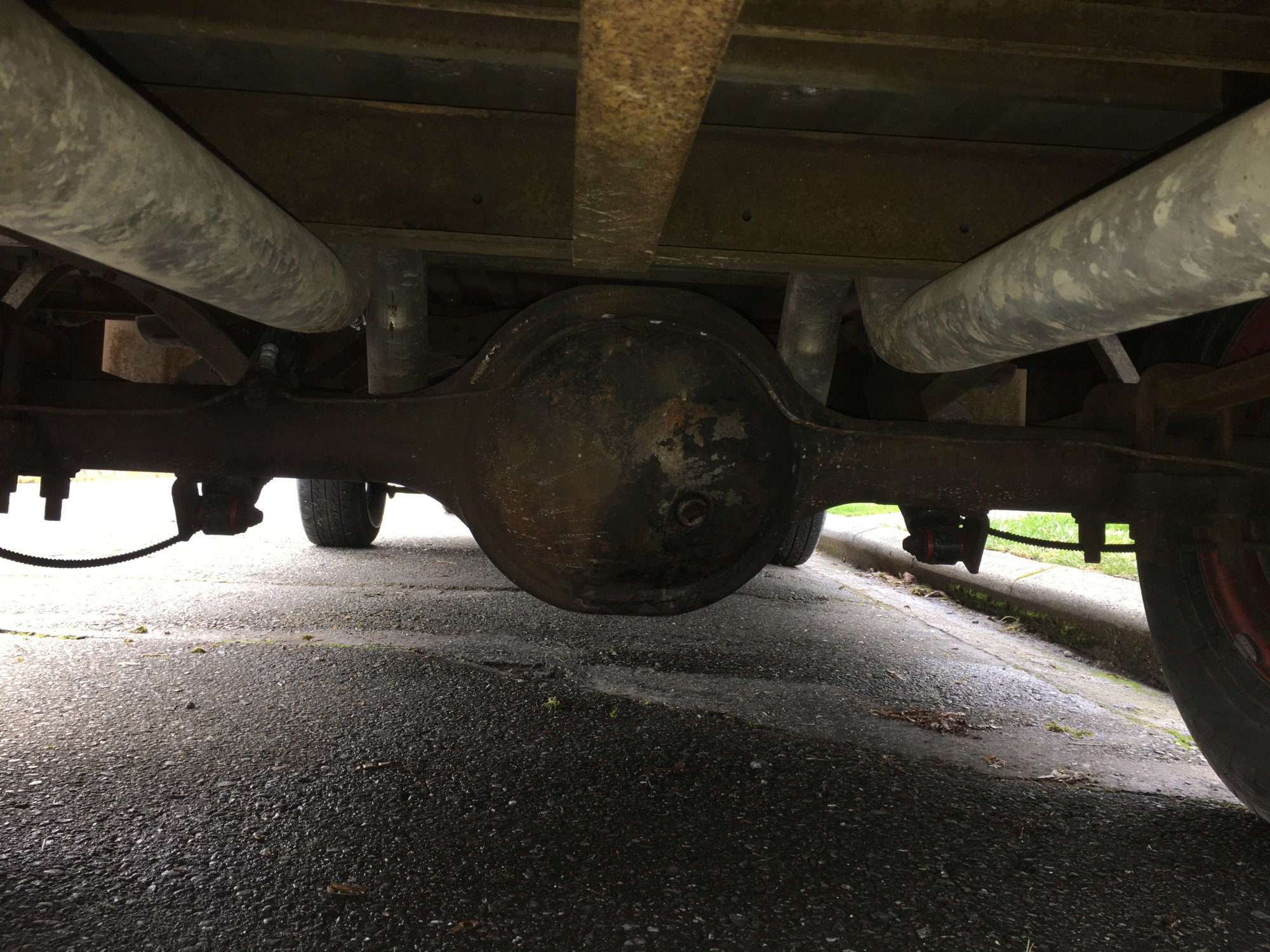

Running through the threads on rear axle ratios, I looked under the back expecting to find an axle with bolts on the back plate and either a tab or missing tab with the ratios on it. My rear axle doesn't have bolts on the back. Is this axle from some other vehicle? Mine a 1963 F100 shortbed wrongside.

Nevermind. Found a drawing showing that the access bolts are on the front. Duh.

9" does not have an inspection cover, the optional Dana 44 & Dana 60.2 (1963/66 F100) do (both have Limited Slip, the 9" does not).
9" referred to as a "drop out" rear axle because the carrier (aka pumpkin - 4141 in pic) can be removed as a unit with all the parts (excepting the axle shafts) intact.
The ID tag (if still present, most aren't today) located at approx. 5 o'clock under one of the bolts that retains the carrier to the housing.
AXLE code stamped on the 2nd line-far right of the Warranty Plate, riveted to the left door face (1963/79) below the latch. Post what the code is.

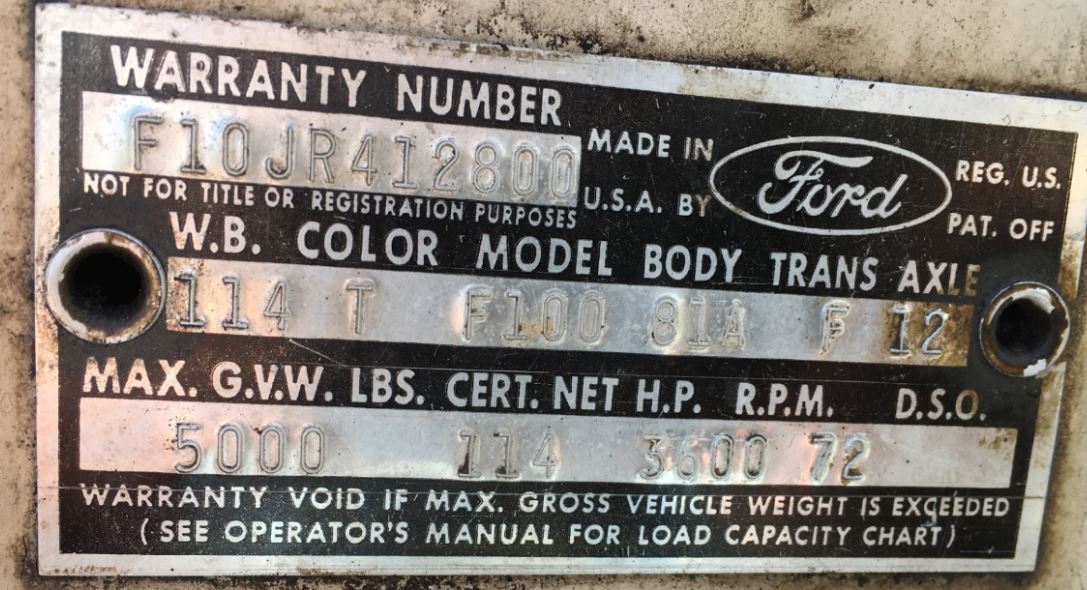

That's where I got confused thanks. That data panel in the left door says the axle is '12'

F10 = F100 2WD
J = 223 1V I-6.
R = San Jose CA Assembly Plant.
412800 = 1963, assembled May 1963.
114" Wheelbase.
T = Sandshell Beige.
F100 2WD; 5,000 lbs. GVWR
81A = Standard Cab.
F = Borg-Warner T-98 4 Speed Manual Transmission.
12 = Ford 9" Rear Axle / 3.89-1 / 3,300 lbs. Rear Axle Capacity.
5,000 lbs. Gross Vehicle Weight Rating.
114 net HP @ 3,600 RPM
72 = San Jose (NorCal) Ford District Sales Office, where the original selling dealer ordered the truck from.

Talking Wow this has changed
F10 = F100 2WD
J = 223 1V I-6. - Now has 351 Winsor
114" Wheelbase.
81A = Standard Cab.
F = Borg-Warner T-98 4 Speed Manual Transmission. Now has a C6 automatic
114 net HP @ 3,600 RPM Got a little more now I'm thinking.
Thanks Numberdummy, now I know what a Frankenstein I have.

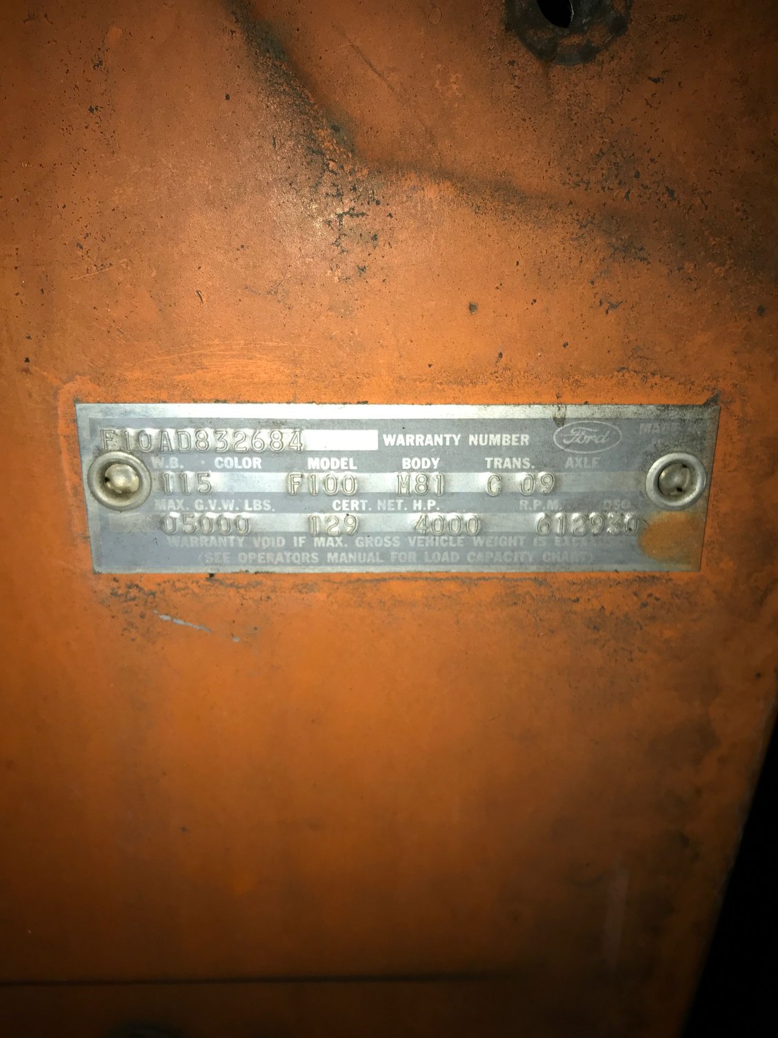

Numbers Dummy, mind decoding another one?
