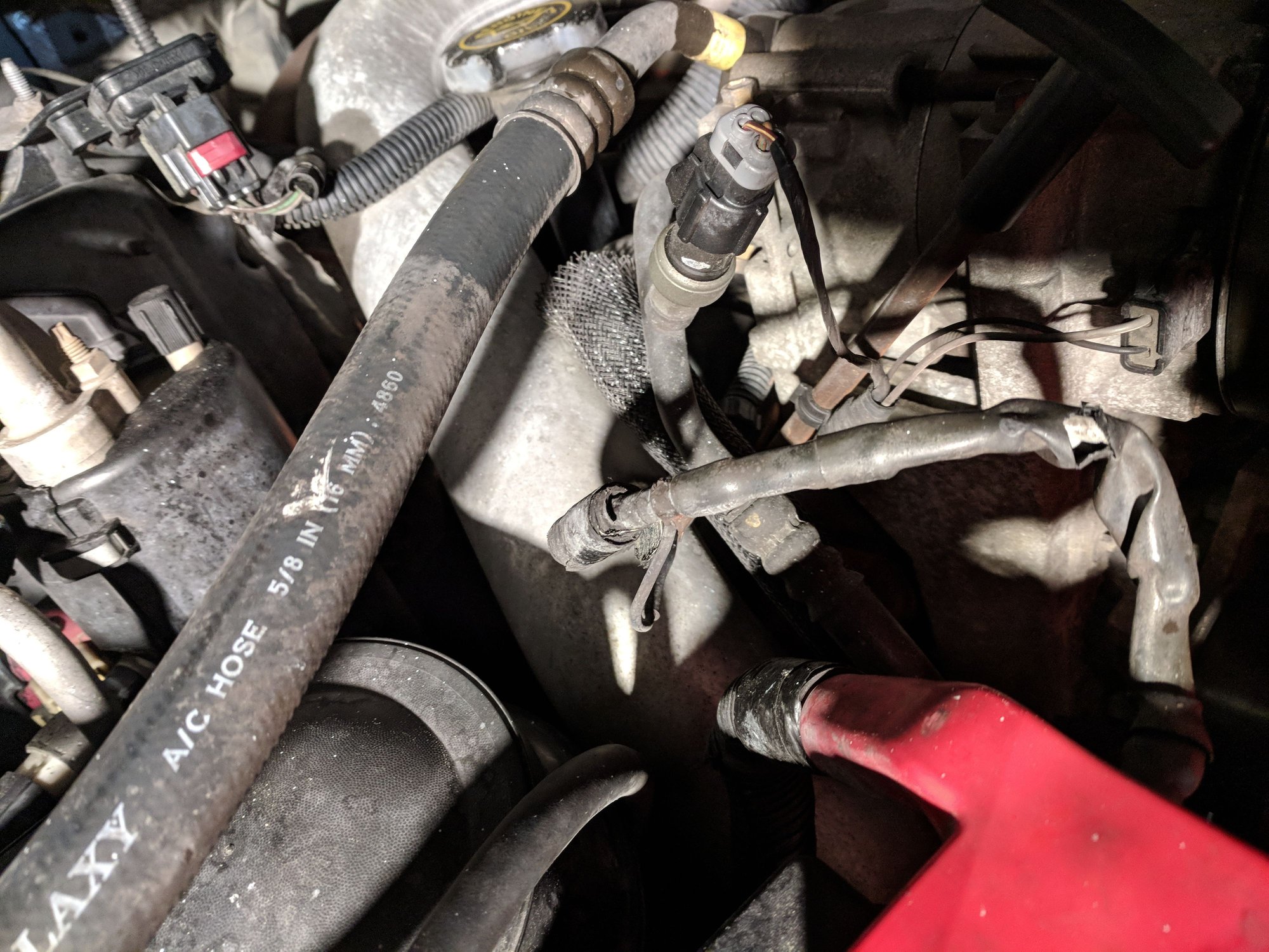

Old Mar 7, 2018 | 07:01 PM
ford73turbodiesel's Avatar
ford73turbodiesel
Joined: Mar 2018
Posts: 34
Old Mar 7, 2018 | 07:03 PM
ford73turbodiesel
Joined: Mar 2018
Posts: 34
That guy right there next to the red battery cap says "fuselink" I'm guessing that's it? Can I buy a new one of those or what do I do now?
Old Mar 7, 2018 | 07:11 PM
99f350sd's Avatar
99f350sd
Joined: May 2003
Posts: 9,303
Likes: 48
From: Lyndonville, Vermont
do you have a yellow and white tracer wire? and is there 12v on it Connector unplugged.
