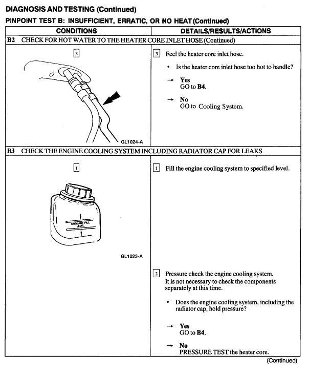

Old Mar 5, 2018 | 12:02 PM
Chad T. Keogh's Avatar
Chad T. Keogh
Joined: Jul 2017
Posts: 278
From: Penticton, BC, Canada

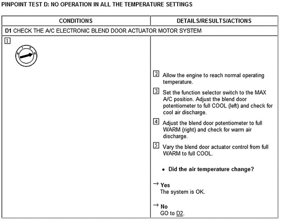

Old Mar 5, 2018 | 12:32 PM
Chad T. Keogh
Joined: Jul 2017
Posts: 278
TEST D:
