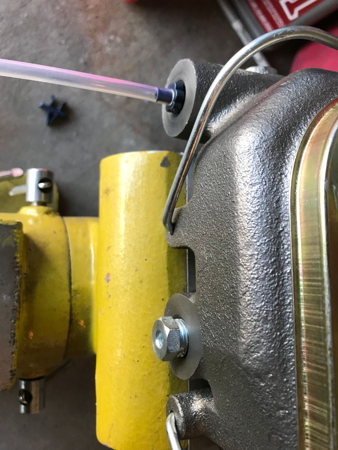

New MC from Speedway…
1) use nothing on fitting threads? How tight?
2) dumb question, but once bled in vice, when I remove plastic nozzles isn’t the fluid going to just pour out of holes as I try to thread fittings back in?

finger tight should work fine ..... after bench bleeding you can plug the ports to stop the fluid from leaking out while you get ready to install your lines.

As long as you don't move the spool you'll only get a few drops (Pascal's Law), but put a plug in it ASAP.

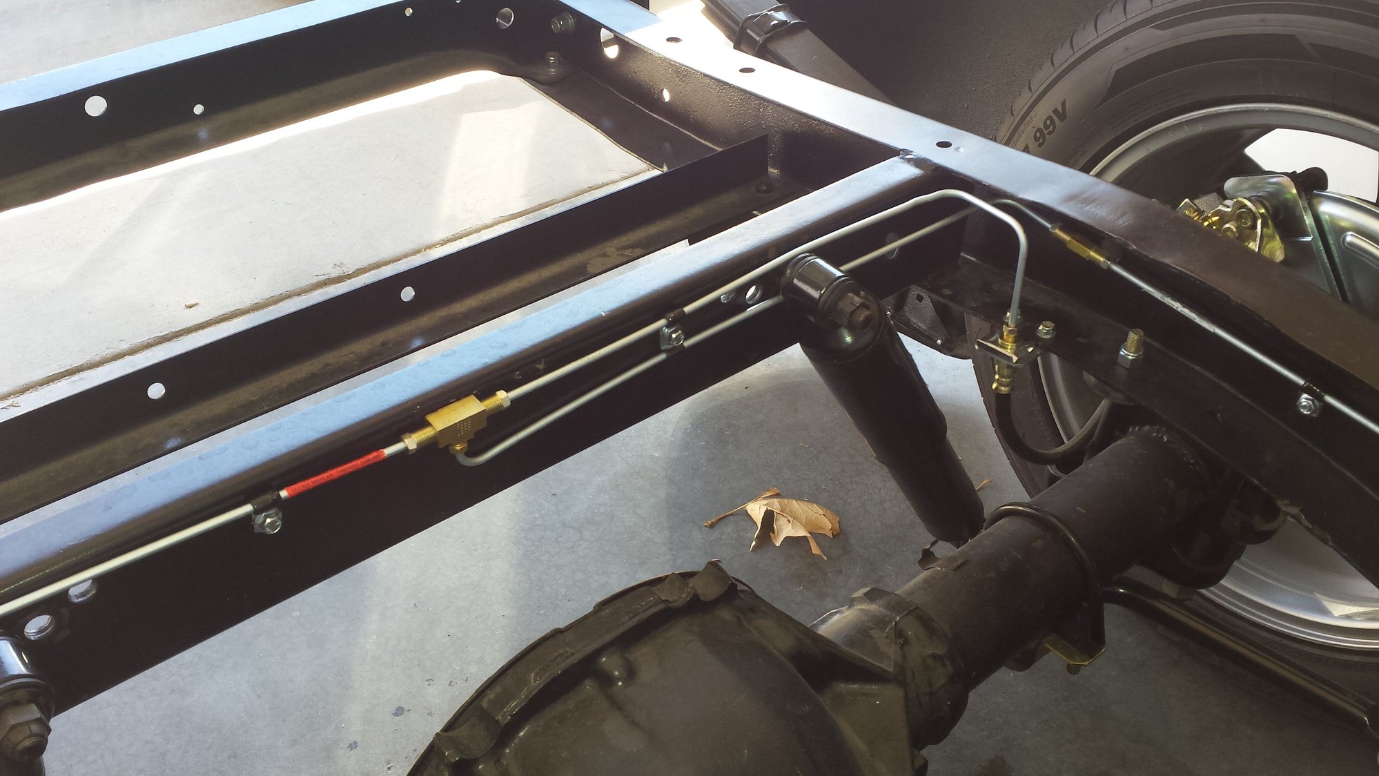

Here is a couple pics of mine. I have 4 wheel disc. I tried using the copper/nickel tubing and flaring them myself, but that didn't go to well. Ended up having 4 of the flares leaking. Probably from my cheap azz flaring tool. So I ended up tearing it all out. I bought a brake line kit from speedway that has preflared lines in different lengths. The hard part for me,was figuring what way to route the lines, so I ended up with the right length. So I wouldn't have to cut & flare.

Thanks, that is helpful to see...
Yeah, I'm a bit nervous about my flares — guess we'll find out eventually!
