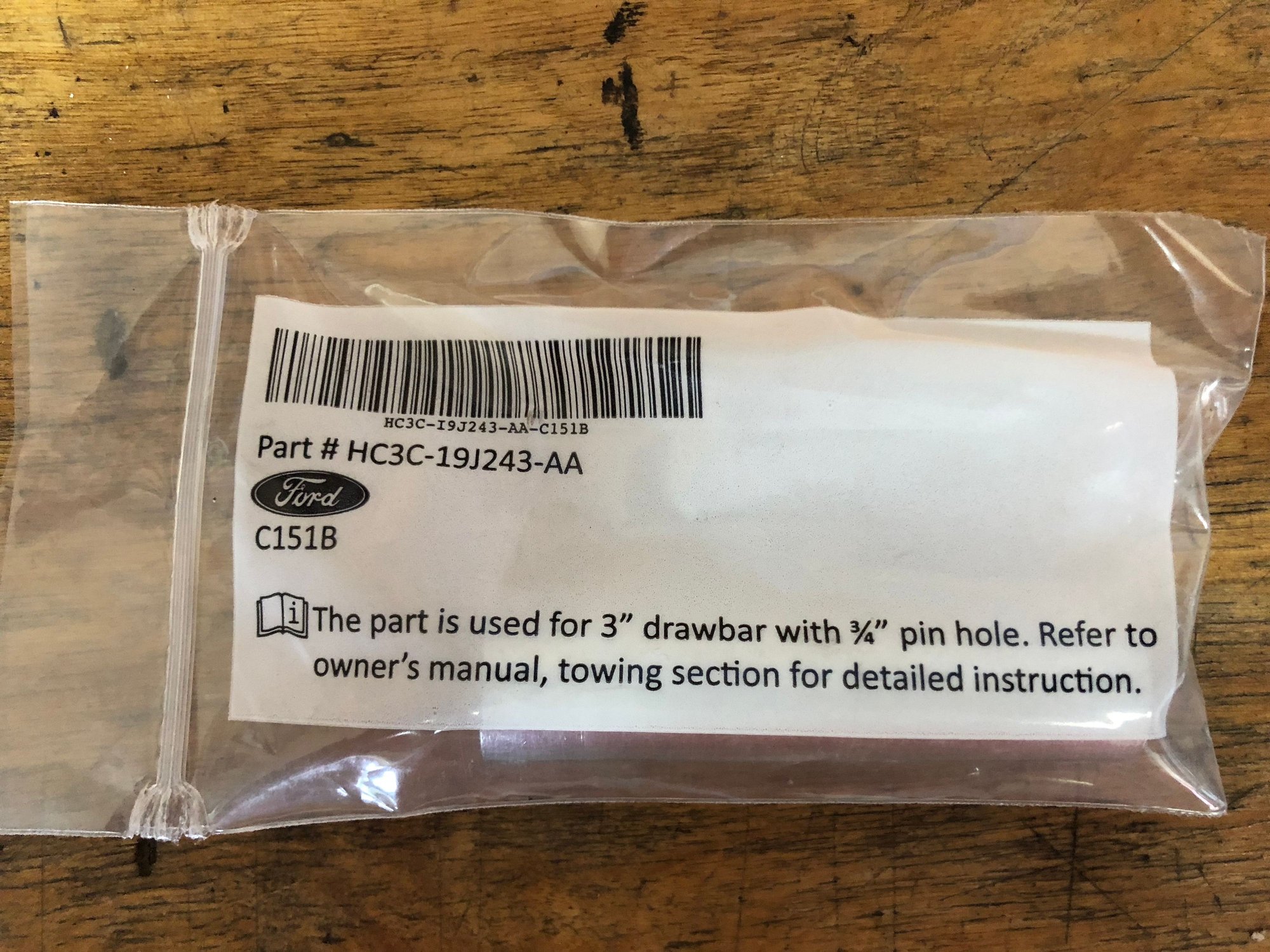

You should also get this in the glovebox...
Thank you very much for the help. I will confirm once I get back in town.

Yep - that is a 3/4 to 5/8 reducing sleeve that slides into the draw bar (if it has a 3/4 hole) to make it compatible with the 5/8" pin.

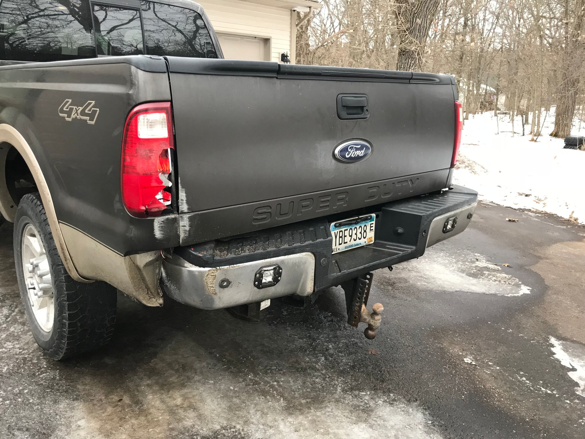

Curt makes a stout hitch. This one is a 2” that survived a hit that almost broke the factory receiver in half. It now gets used around the farm just to be safe and not run it on the open road but no bends or broken welds. Will be ordering the 2.5” and using a reducer for my new truck.
