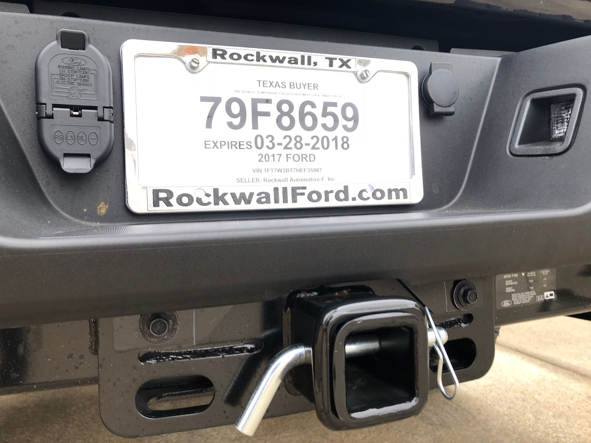

Here’s the receiver on my new F-250. If I take that sleeve out, isn’t that 3” I’m left with??

You’d have to measure it as it’s hard to tell measurements from a pic. If it’s not an hd tow pkg. equipped 250, it is a 2.5” though unless Ford installed the wrong hitch on your truck. Also note that the 3” receiver comes with two adapter sleeves and you only have one in your pic.

Unless you're missing a reducer that's a 2.5". My 250 has the HD Tow Package with the 3" receiver and it came with two reducers. One to go to 2.5" and another to reduce that down to 2".

That reducer appears to have a flange around the edge so it won’t slip into the hitch. My 3”-2.5” looks exactly like that, then I have a 2.5”-2” with no flange. I think you’re missing a reducer.
