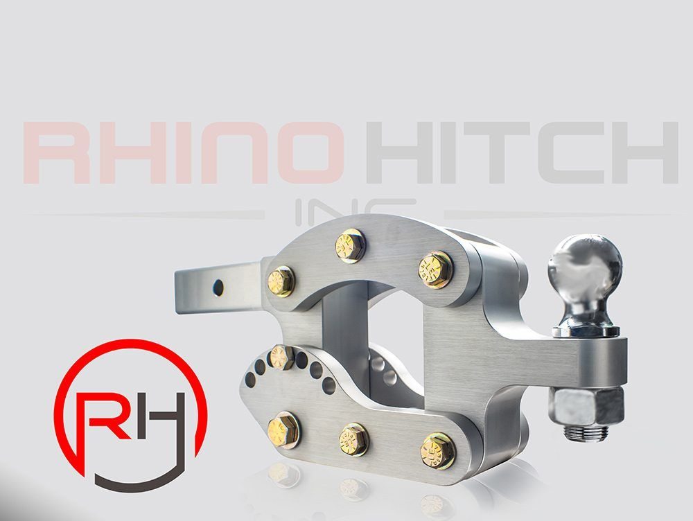

Anyone ever try this unusual looking apparatus? Says it’s rated for 14k.
Gen Y has one similar.
If I am not mistaken the GenY hitch is a rubber torsion hitch were it provides suspension for the trailer.
The Rhino Hitch looks like it is just an adjustable height hitch.
O yeah, I just assumed the Rhino Hitch had suspension as well. They look so similar.
