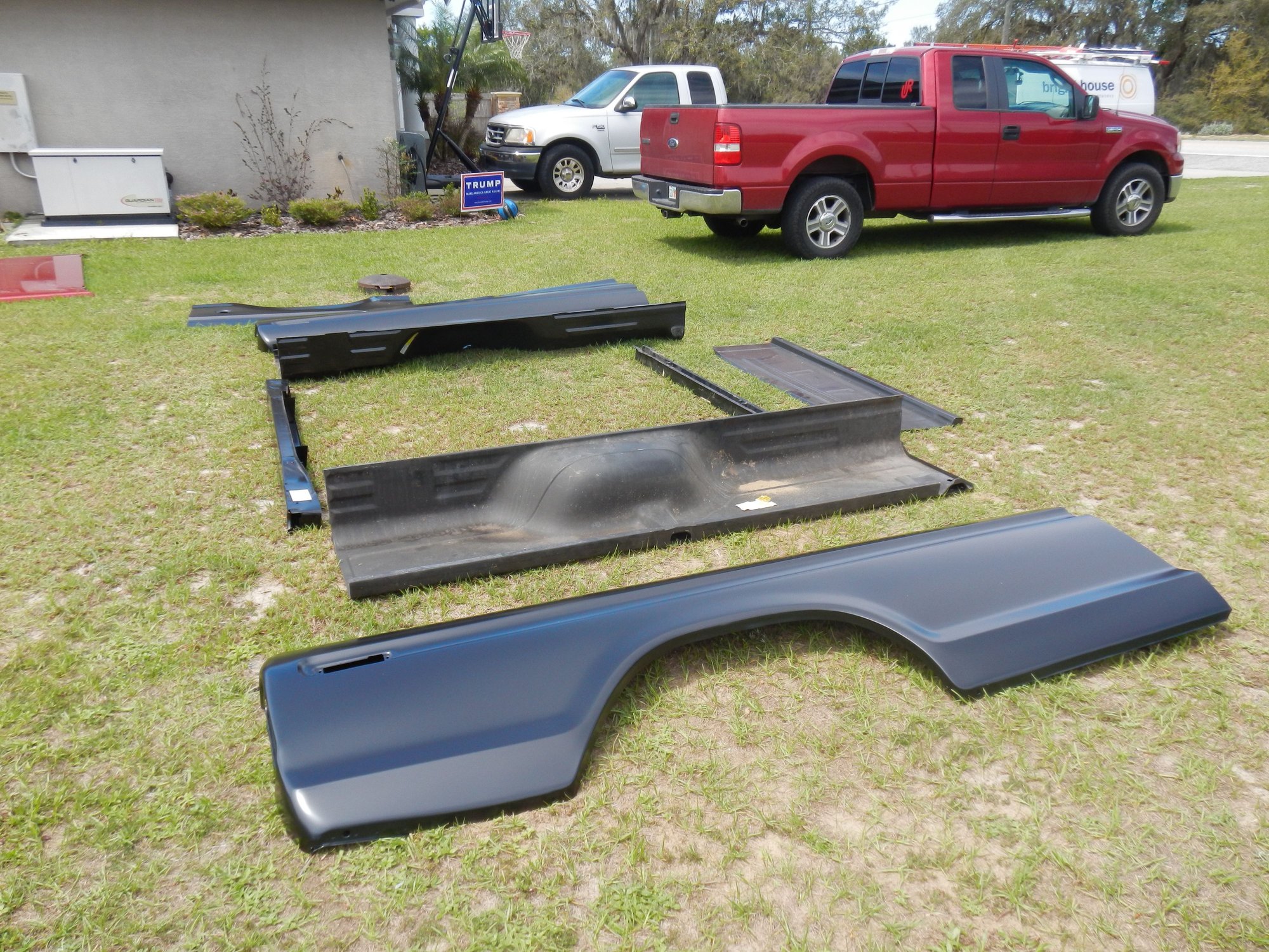

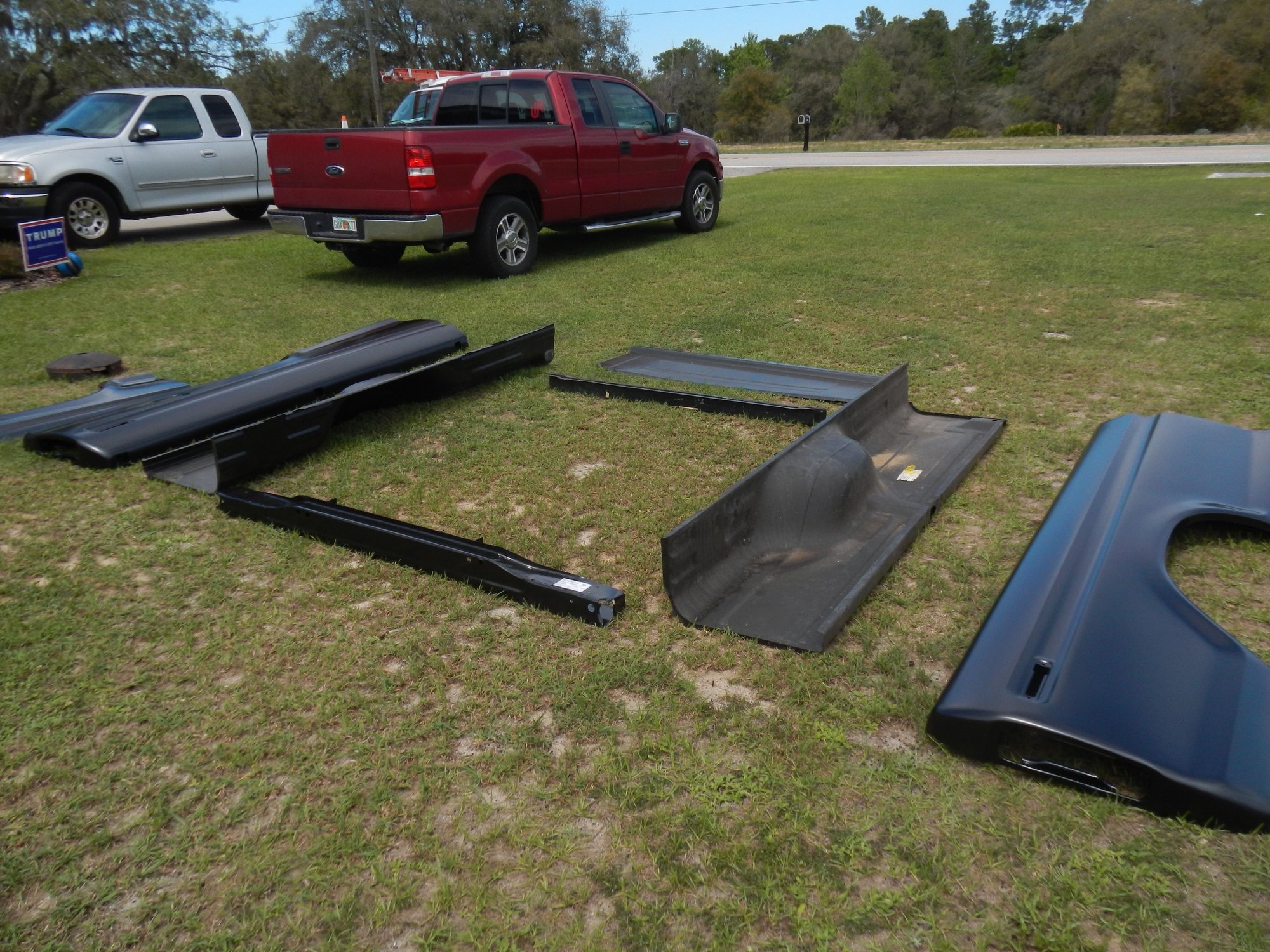

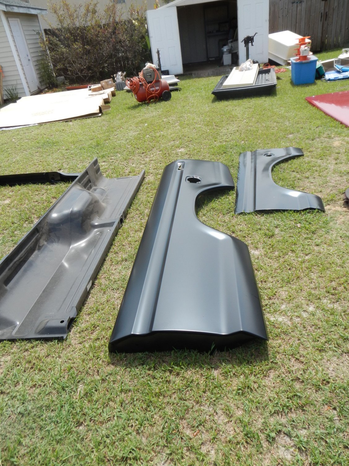

Originally Posted by needs2bsedated
I just purchased metal for 77 f250. almost the whole bed. may have to before its all said and done. Read a post from a while ago from Bud Mud (search the name) pretty good info. He says he uses Sherman body panels. claims never had a problem with fit, and has done I believe about 20 dent sides. That is why I went with them. Also ordered through Summit racing because they are about 30 40 minutes from me. Would hate to have to pay that shipping, oversize, truck freight, and whatever else they can throw at you. He also said NPD was pretty good
Since you have some bedsides right now can you take a look and see how well they match up with originals. As far as body lines go as well as thickness. Also I've noticed some pannels lack the defined indentation body line over the bed's fender. That would really help me out if you could take a look at it compared to the originals even if they are rusted out.

Well I may go with NPD. I'm picky about lines and also having it as close as possible to the original. Compared to the original the bottom of the bedside runs the same and all? They look really good of course not 100% the same I'd guess. The only part that bothers me in aftermarket besides is the loss of the line in the green circle that goes around the wheel well. And the one body line fading in too much that runs along the bottom.
