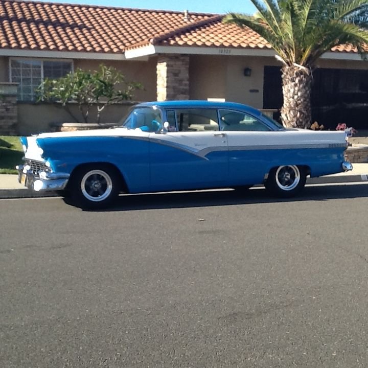

msg and pup, cycled it with the remote start and it recycled correctly. As for using the remote, the truck seems to have its own mind on what to do with inside temp so I'll need to watch the AC clutch on a first start start. I leave the complete HVAC off along with the radio when I shut off the truck; but using the remote start and getting in after a few minutes and touching the start button to energize the dash the HVAC will be on doing what it thinks I want. I've had the cold on my seat on, the heat on, and it off. I'm guessing since I used the remote it will respond to the outside temp versus the inside temp and correct it all.
Geez I love the heater in my 56 Victoria. Slide the temp to high, move the lever to heat or defrost, and select hi-low for the fan. AC is open the windows, pull the ***** for air at your feet and adjust the wind wings (remember those) to about 45*....
