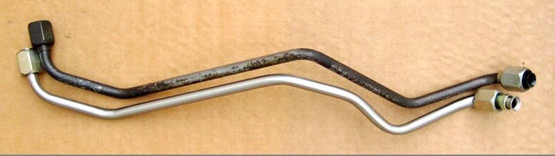

If your new tube came from Ford and was purchased after 2001, it is bent differently, making it MUCH easier to install. Ford must have finally realized the issue with dual alternators and reformed the tube bend pattern to enable easier service/installation. I'm curious which design tube you were trying to reinstall, after your report of spending hours trying to thread it through. Did you have an old stock tube with the original bend? A new aftermarket tube that was a knock off of the original bend pattern?
The difference is subtle, but it makes ALL the difference in the world as far as frustration versus fitment is concerned. Have a look at my old tube on top, and the new tube on the bottom, in the photo below...

I can't emphasize enough that the difference in bends between the two tubes depicted above DEFINES the difference in being able to thread the tube between the head and the front bracket.

I replaced mine about a year ago. I just wanted to make sure that the difficulty you reported was with the new tube. But after asking the question, I realized that it is literally IMPOSSIBLE to install the old tube AT ALL with dual alternators, without removing not only the lower alternator, but I'm guessing the bracket as well. I'm sure most people would take difficult over impossible. Or wriggling and wrangling over more wrenching.

Wound up draining the coolant, pulling the expansion tank, removing the belt tensioner pulley, pulled the AC condenser and zip tied it up out of the way, and pulled the pulley mount and condenser mount. Now I was looking at the clear path to simply place it where it goes and connect the flare fittings. Easy. I have the tube with more bends from Clay. Not saying that design couldn't be somehow inserted without have to expose the path, but I worked at it for 4 hrs yesterday, and decided to "make it easy"???
