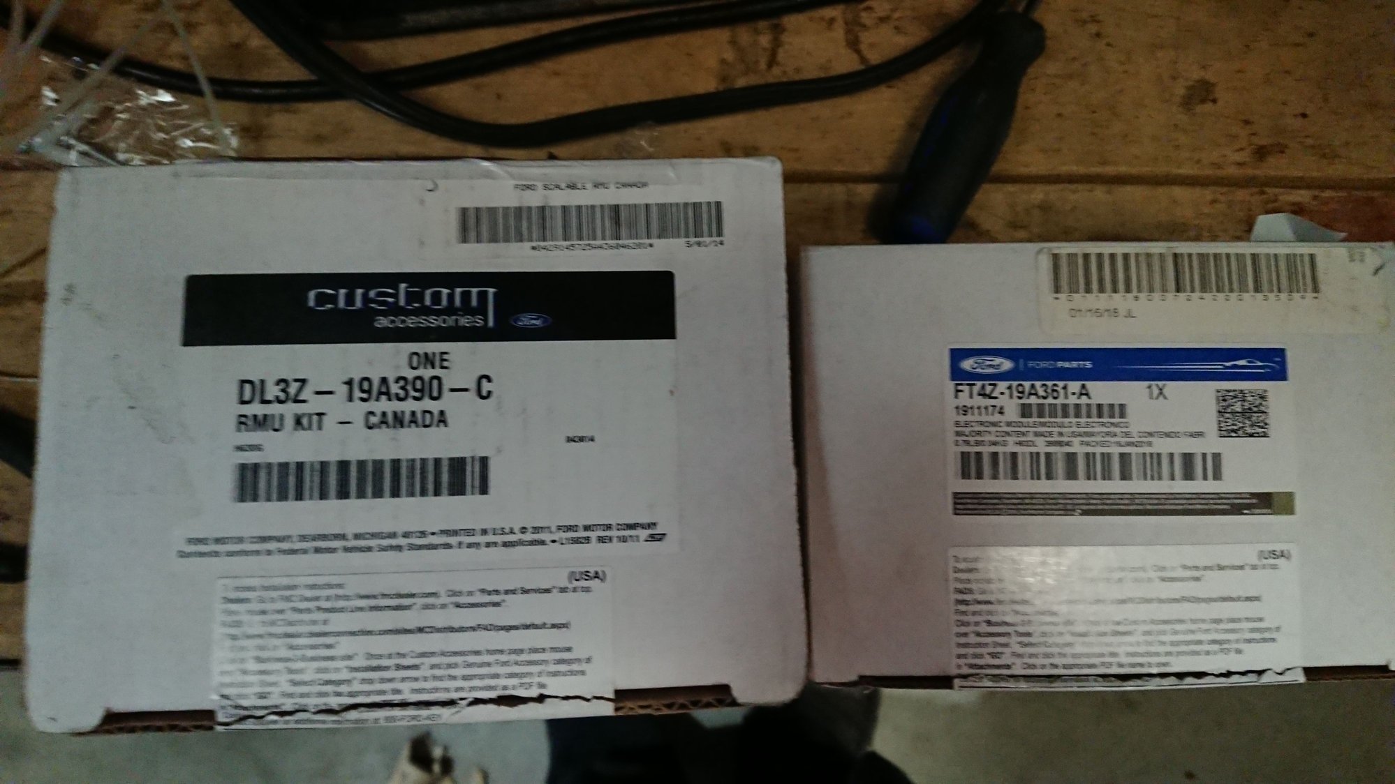

Just to be clear for everyone remote access does work for 2018 superdutys. These two parts will add perimiter plus an added security feature on top of whtaever you already have and the ability to use your phone for alerts, starts,locks ,unlocks find car, whatever else it does with the remote access app. You could literally use this to start anything the has the same gateway module connector as this harness does. If you dont have remote start already ford or forscan will have to enable it if you do its super easy install and then call ford get them to activate the sim that came with they will give you a pin and your good to go. I will add ford had to say it was a 17 Superduty and did not provide a vin on there PTS program to activate and get the pin but like i said it would start anything with same Gateway plug. The DL3Z 19A390-C is the canadian version vs DL3Z 19A390-B but i do beleive either will work not 100% on that. Cheers
