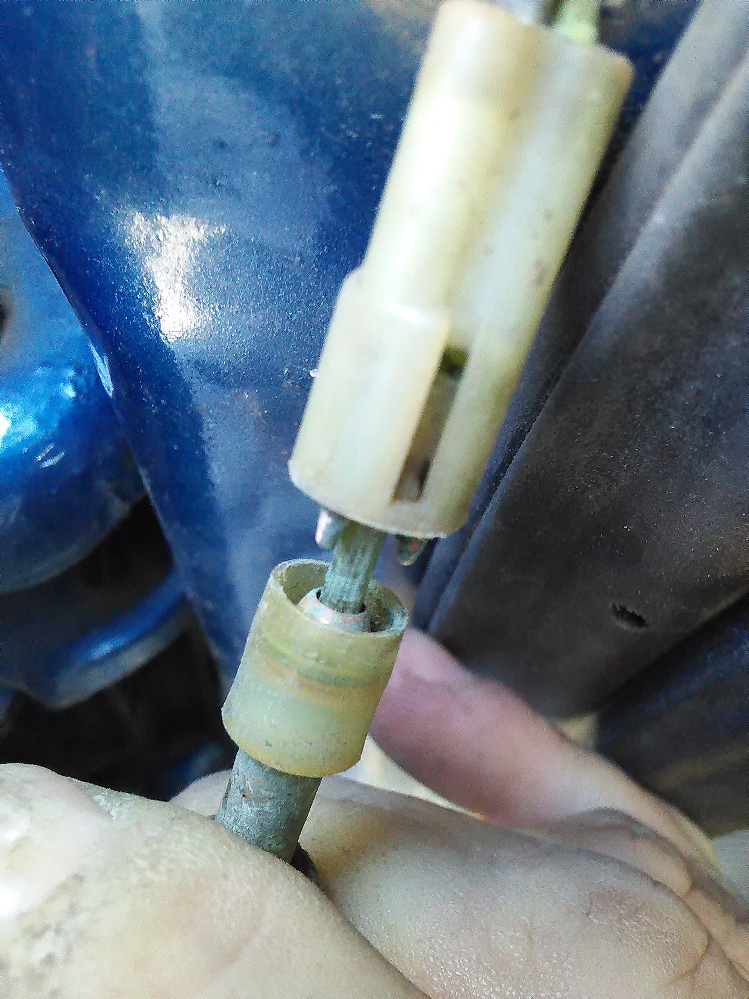

My heater/defrost lever and cable were stiff, so I squirted a little PB Blaster into each end of the cable, and worked it back and forth. It's still squeaky and not as smooth as it was 40 years ago, but it is a little better.
The temperature selector lever and cable were stiff, and disconnected from the crank-lever deal at the bottom of the heater box. So I sprayed some PB Blaster into that cable, and bent the end of the cable so that it would travel more smoothly, and stay on the crank lever. So now my temperature selector works!

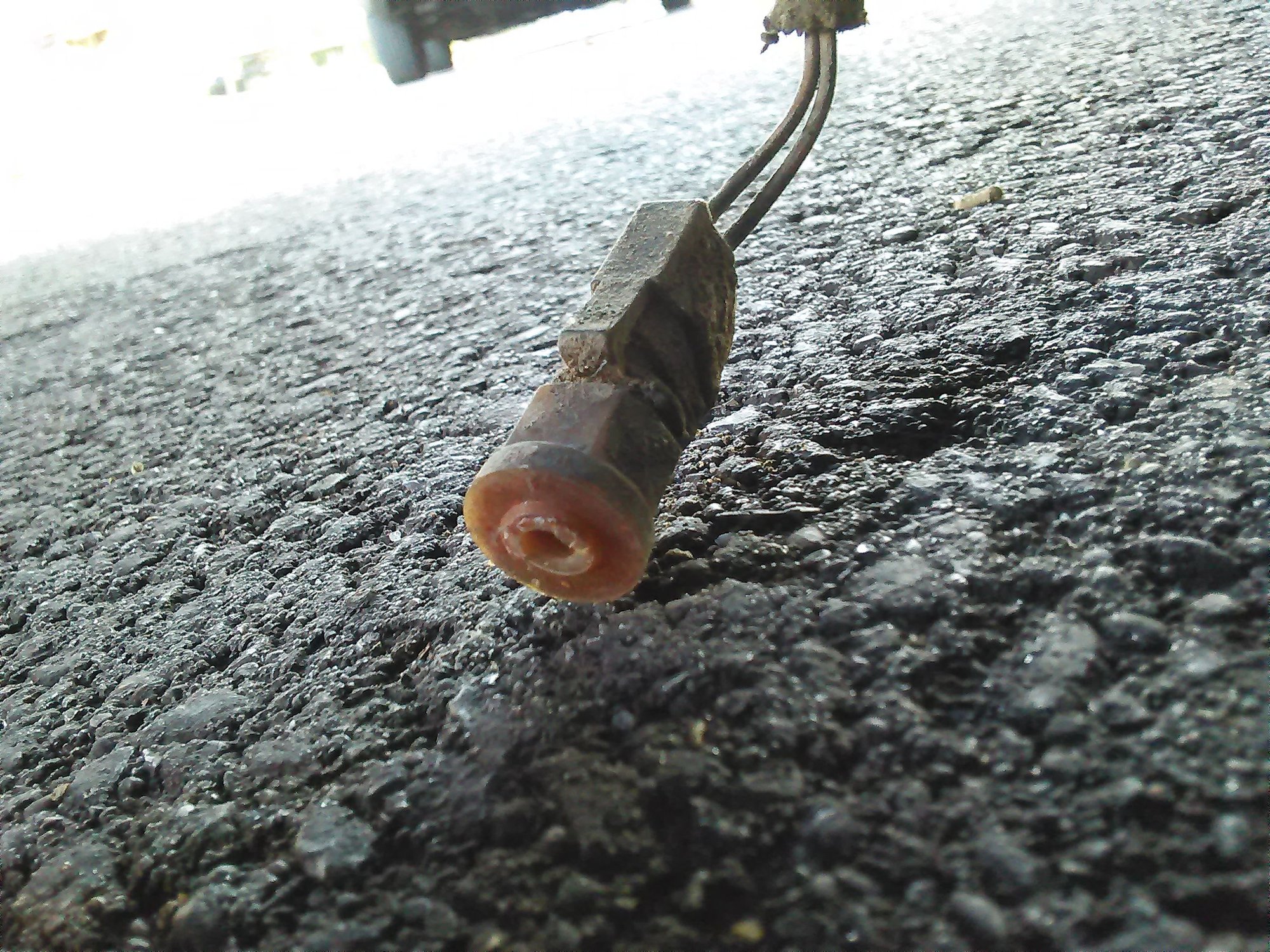

Would the brake light not illuminate because the switch is broken off and hanging under the truck?
Is that what this is? I discovered that when changing my oil yesterday.

I went after my broken Brake Warning Lamp switch. The top was plugged into the wire harness connector, and the bottom was threaded into the metering/proportioning/pressure differential valve.
So I took a flat blade screwdriver, and heated it with a torch, and then pushed it down through the threaded stub in the PV. I then let it cool down and set up, and simply unscrewed/unthreaded it on out!
I figured this might work, because I experimented with some torch-heated implements, and the other half of the switch, which had been plugged into the wiring harness...
New-to-me switch went right in.

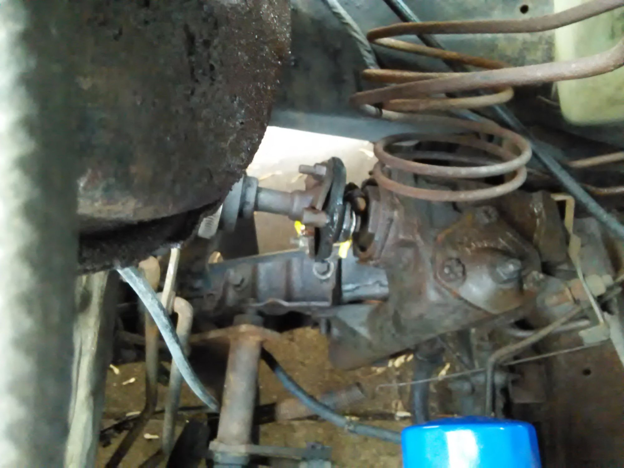

I fixed my rear axle vent.
Last night I was driving it, and I noticed a gear-oil smell. I figured it was the transmission, but it looked OK, as did the engine. Finally, I thought to check the insides of the rear tires, and there on the driver side was my leak. I googled the problem and didn't like what I saw.
The one thing I saw which I didn't hate, was the advice that if your axle seals are leaking, you should check your axle housing vent. Today I did, and it was clogged. When I unbolted it, there was the hiss of pressure escaping... It was so clogged that I couldn't poke it free. So I used a drill. The hose had torn off, so I removed what was left, and popped on some hose from the bottom of an old Explorer 5.0 intake manifold, which should suffice for now.
I just hope that my axle seals aren't totally shot.
Now I gotta get in the left rear brake with some brake parts cleaner and sandpaper.
